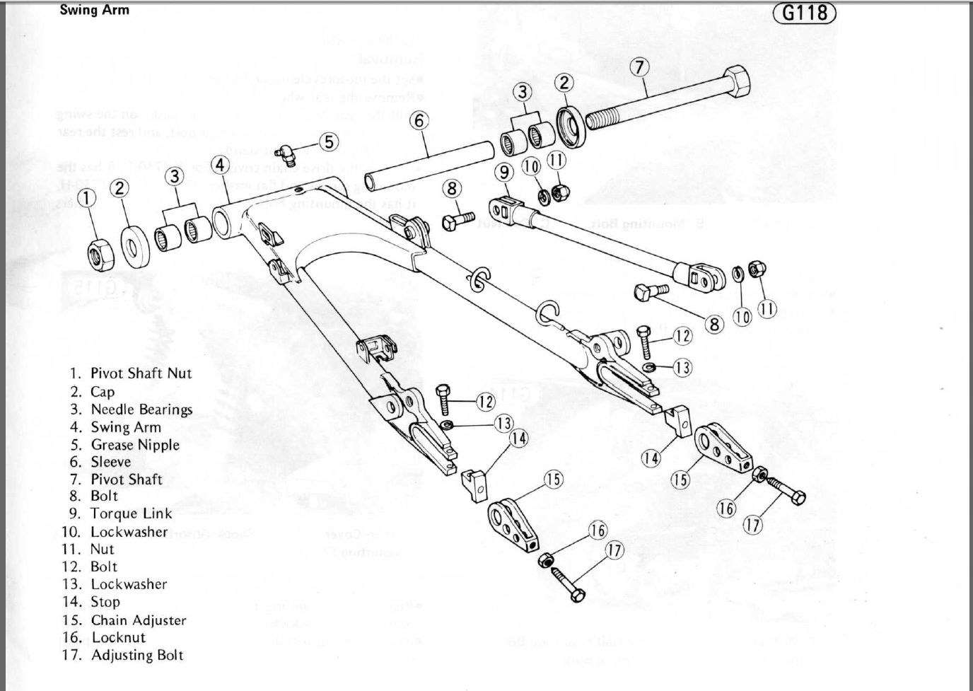

Look for the length of the pivot tube on a kz750e/h. Thanks
1981 KZ750e
- Thanks: 2260
Re: Pivot tube length of kz750e swing arm
11 Sep 2017 14:51
Could not found the correct length but with some math you can get a real near by length.
Swing arm tube width #4 - (4 x needle bearing width #3) = pivot tube length #6

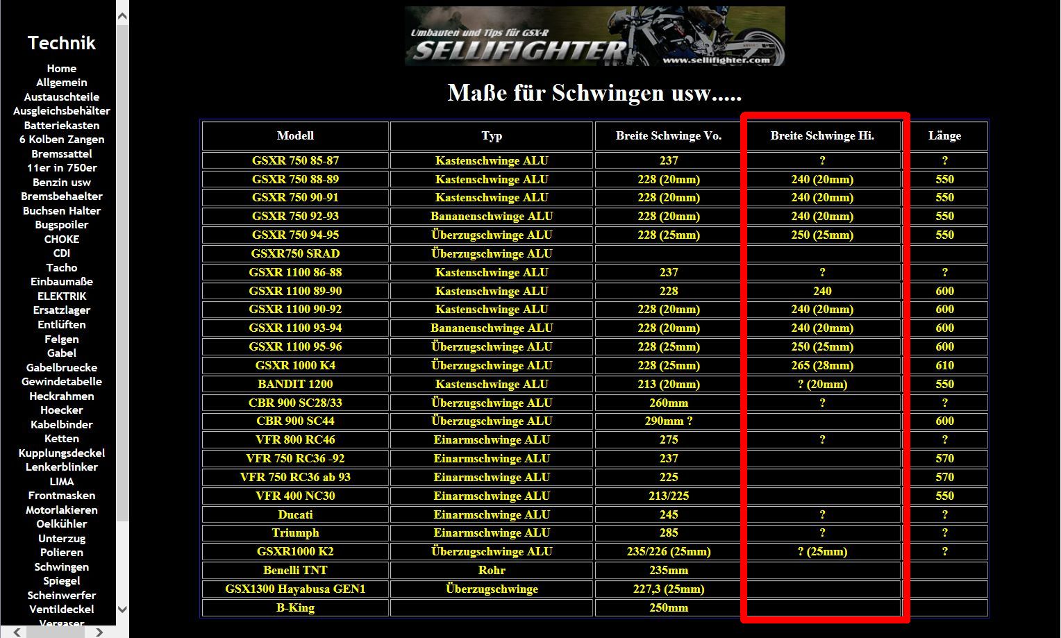

Here are some swing arm charts
swing arm/pivot to frame width in metric mm
swing arm wheel width in metric mm
Länge = swing arm length = pivot to rear axle in metric mm
The values in brackets refer to the pivot or axle OD in metric mm
11 Sep 2017 21:56 - 12 Sep 2017 06:14I stated 232 earlier, but thats on the Zepyr 750.
/A
