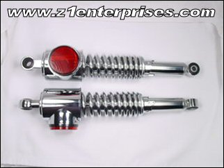

No eBay APP ID and/or Cert ID defined in Kunena configurationI bought the repros from Z1E and remembered why they were so bad. Not good for turns. Got duel rate shocks and I like them though they could be stiffer. Maybe one day I'll get some racing like my S&W's I had before but for now I can "Ride the piss out if it." :woohoo:

I tried the dual rate ones you have pictured - constantly bottomed out even when cranked up to maximum preload, no damping to speak nicely of...like I said, I paid $100 for them.... $100 too much, too. I think your roads are in better shape than the potholes and frost heaves we have here.
