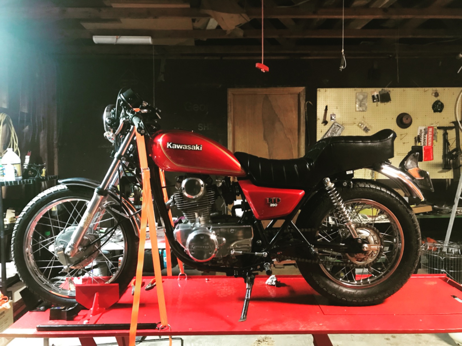

I recently competed this swap and figured I would write up a tutorial as it seems to be a reoccurring problem for 400 owners not being able to get a caliper rebuild kit. I owe a big thanks to Nebr_Rex here for giving me details on this swap.
Here is what you need;
KZ400 wheel
KZ400 disk
KZ400 triple clamps
81-83 KZ440 axle with spacer
81-83 KZ440 forks
KZ440 caliper (or lefthand from kz1000, kz650, kz750. assembly number is 43041-1024 if you want to look up models that used it)
14mm Master cylinder
If you do not have access to a mill or lathe you need to make friends with a machinist
First, turn the 440 axle spacer down to 1.114"
Remove .135" from the right fork bottom, where the speedo sits. This will roughly center the wheel in the forks.
Remove .23" from the left fork caliper bosses
This is all that is needed to run the 440 disk. However the 440 forks are 2 1/16th longer than the 400 forks. They are easy to shorten.
Cut two 2.0625" tubes. I used 3/4"OD .065" wall mild steel. I have heard of people using PVC but i like metal. insert this spacer under the return spring on the dampener rod.
Cut of 1.75" off the fork springs. make sure to cut the big end not the small end. This will add some preload to the fork, since im a big guy and i thought the forks were a little soft I did this. you can still get the cap and retaining clip in easily.
Reassemble forks as normal using the 145-155ml of fork oil as per the FSM. While you're at it put in some fork seals. (the 440 is on the left, 400 on the right)
The fender mounts are different on the 440 forks. I used one of the existing holes in the 400 fender mount, drilled another hole, and trimmed the excess. This mounts the fender much closer the tire, i thought the stock position was too high anyway. I also cut and drilled the fender struts to match.
Thats all there is too it. Hopefully this helps someone when they are looking for a solution for their 400 brake.

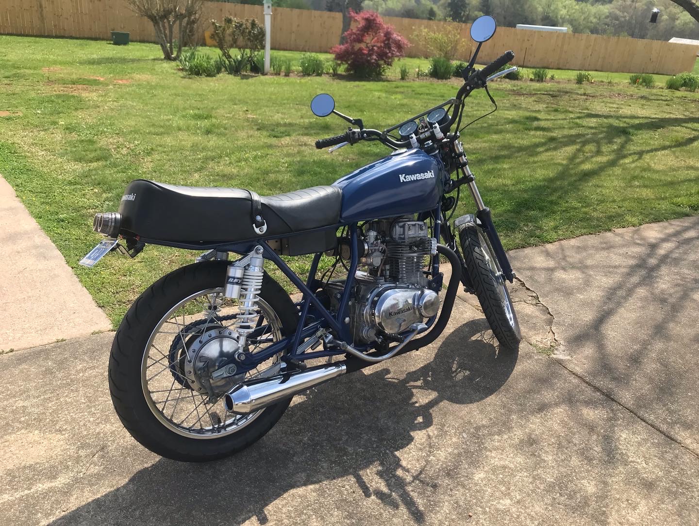

I was the lucky one with the 78 KZ400 B1 that tried this swap. DoctoRot asked me to get a write up going if I could get this sorted. And well no doubt we got ourselves a workaround.
Just as before a mill lathe is gonna be handy. I had to make my own axle spacer, but potentially something similar could be found, modified ...

Okay now its time for the fun part. Reassemble the left fork using the modified fork boot from the KZ440 and all the original guts, springs, dampers, tubes, caps, spacers from your KZ400 fork. This will ensure the heights and everything else will be stock with the forks except for of course the left fork boot. Mount your front axel as you would before and slip on the custom spacer between the boot and speedo. Tighten up the axle, mount the caliper, and bask in the glory of a job well done.
I went ahead and junked the original caliper, got a used 2013 Ninja 300 caliper from ebay for cheap. Got rid of the hydraulic brake light pressure switch and put in a steel braided line. And of course moved the wires over from the pressure switch to the micro switch on the new caliper.
