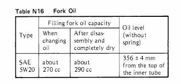

You are correct that the FSM does not specifically state SAE 5W20 fork oil under the heading "Type", but the little table has the title "Fork Oil" and the subtitle is "Filling fork oil capacity."
I guess it's a matter of interpretation on the part of the mechanic as to whether the term "fork oil" in the title and subtitle is intended to inform him to use fork oil if it is simply intended to mean the oil that goes into the forks. The KZ650 FSM is written in similar fashion, but for sure the KZ650 forks are meant to run fork oil, so I suspect the same is true of the KZ550. Ed

Does the 650 manual specify, explicitly to use oil intended for forks and not oil for motors?
As you pointed out, maybe it's a philosophical question... if you use some oil to polish your silverware, and that silverware includes a fork, does that make it fork oil?

My manual says non detergent, We use to use hydraulic oil.Years ago I used Castrol 20-50. It worked until I could get some REAL fork oil.

15 Jun 2017 20:21loudhvx wrote: Does the 650 manual specify, explicitly to use oil intended for forks and not oil for motors?
No. It is consistent in that it always uses the phrase "front fork oil" but it does not say anything about not using motor oil. I bought my bike new, and when I spoke with the Kawasaki dealer the first time I serviced the front forks he said the forks needed to use fork oil. That's what the dealer used in all Kawasaki forks. Ed
