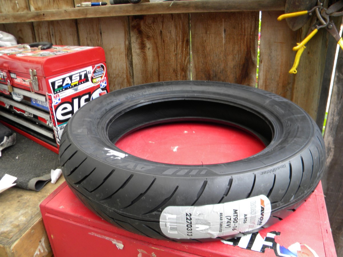

Just ordered a pair of Avon am26 from J&P....Never mounted a motorcycle tire before...wish me luck!
