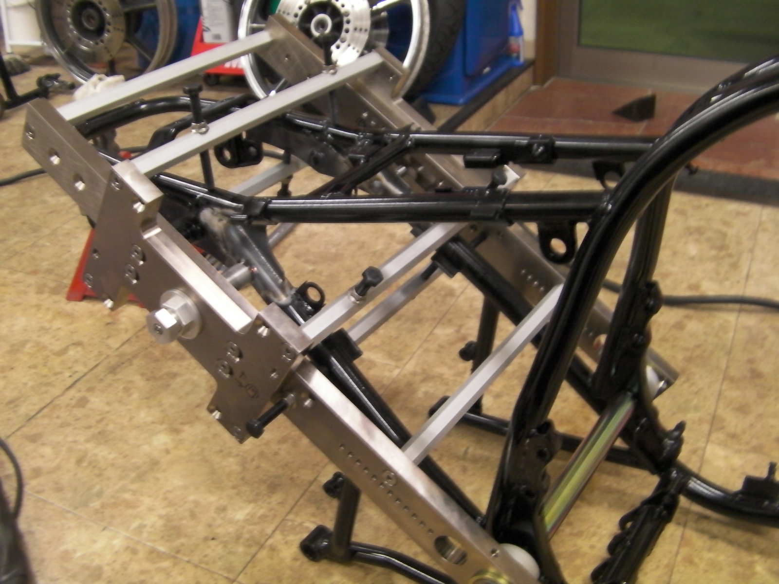

they use this jig to make sure they are in the right place.
beyond that i am of no help. :whistle:

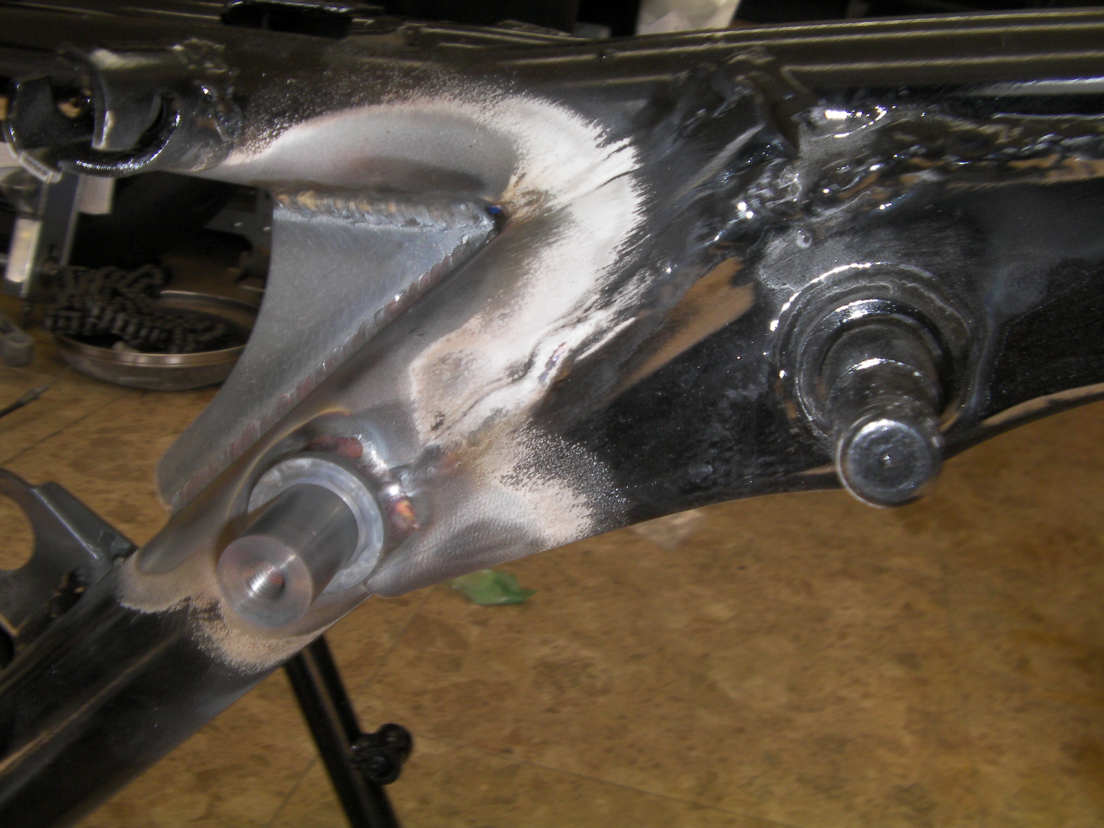

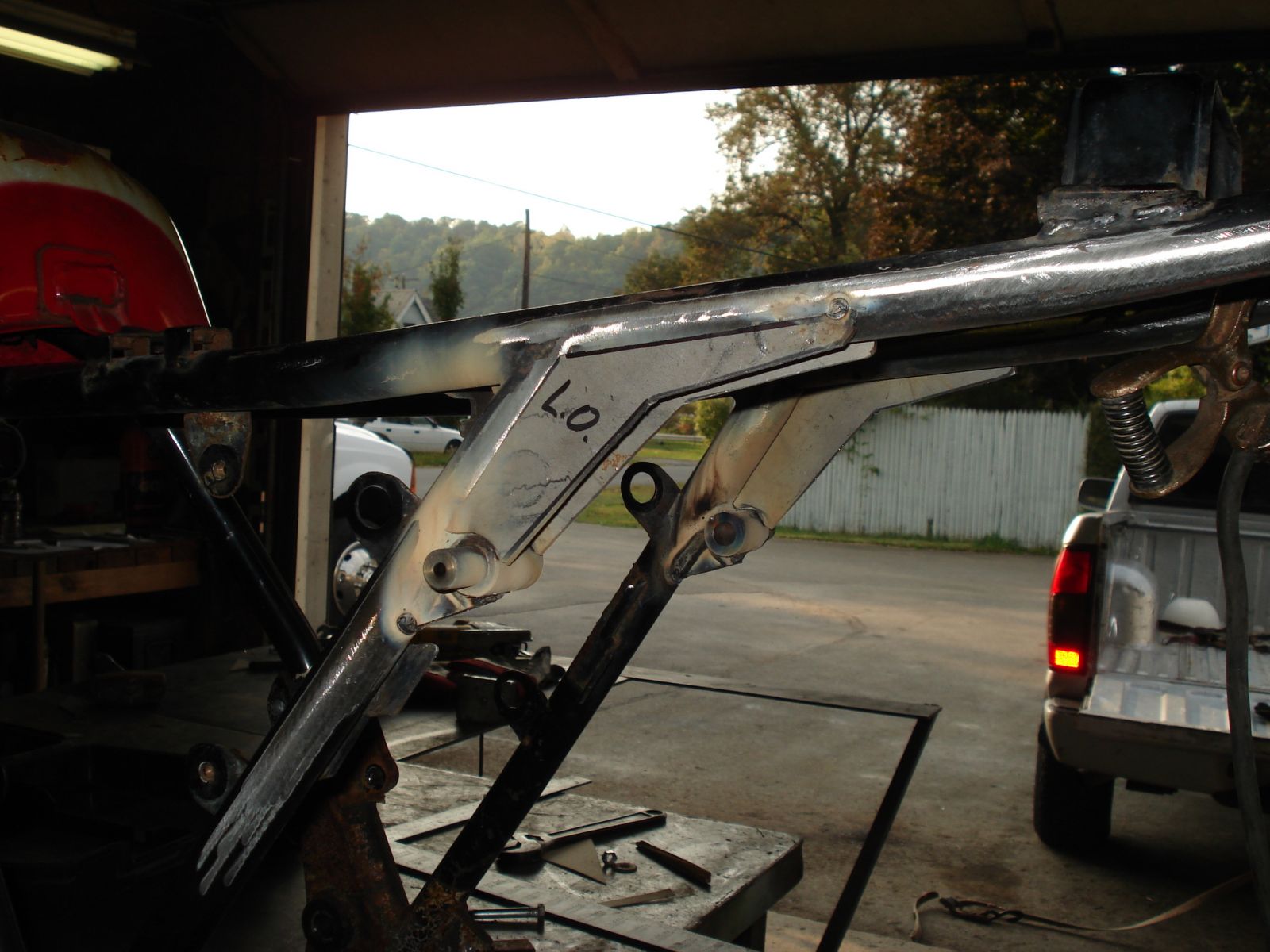

Thanks for the pics Leon, I am gearing up to do mine as soon as I have my box swingarm finished. I was going to make an alignment jig too but that thing is a monster, jeez... :laugh: I'm going to make a simple small jig that slips over the stock mounts with a drill guide for the new mounts.
