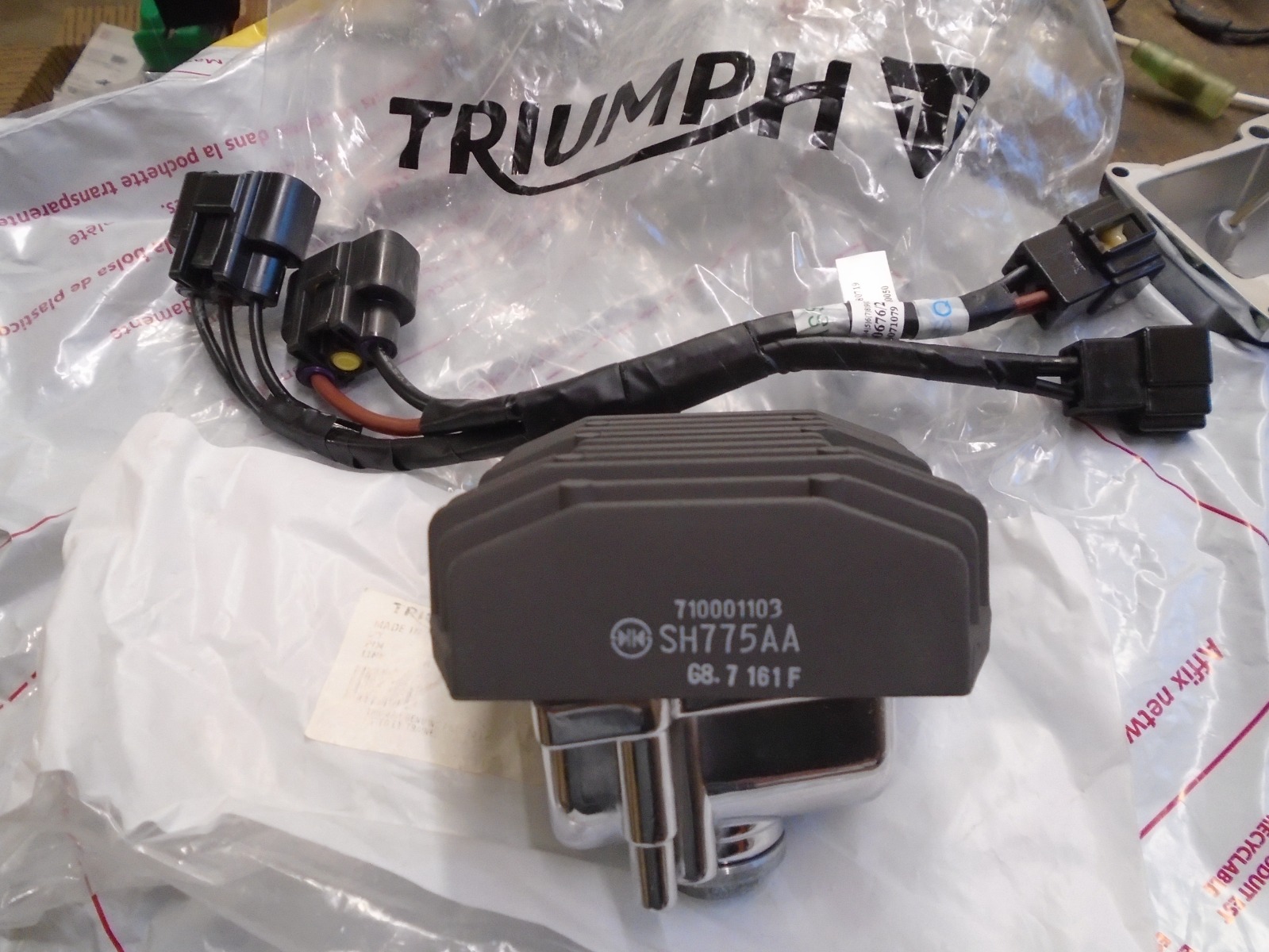

16 May 2026 05:26
Something to consider, givin' the bike is anything but original. Upgrade to a "series" type R/R replacing the ole "shunt" style. Ness has a whole write-up on it somewhere. I use them all the time on bikes like yours when "rivet" counting originality isn't soo important. I keep these two pieces on hand, R/R and it's matching cable in case i need them. And, it's Not a crappy Chinese Aftermarket replacement. You are correct though, lots of those 14.99 Amazon piles of poo out there ha. Superior "clipped" consistent output thru the rev range. Food for thought.. But like Wookie stated!! If bulb is dimming, probably headlight, for no other apparent reason. You have some sort of "other" wiring issues going on!!
