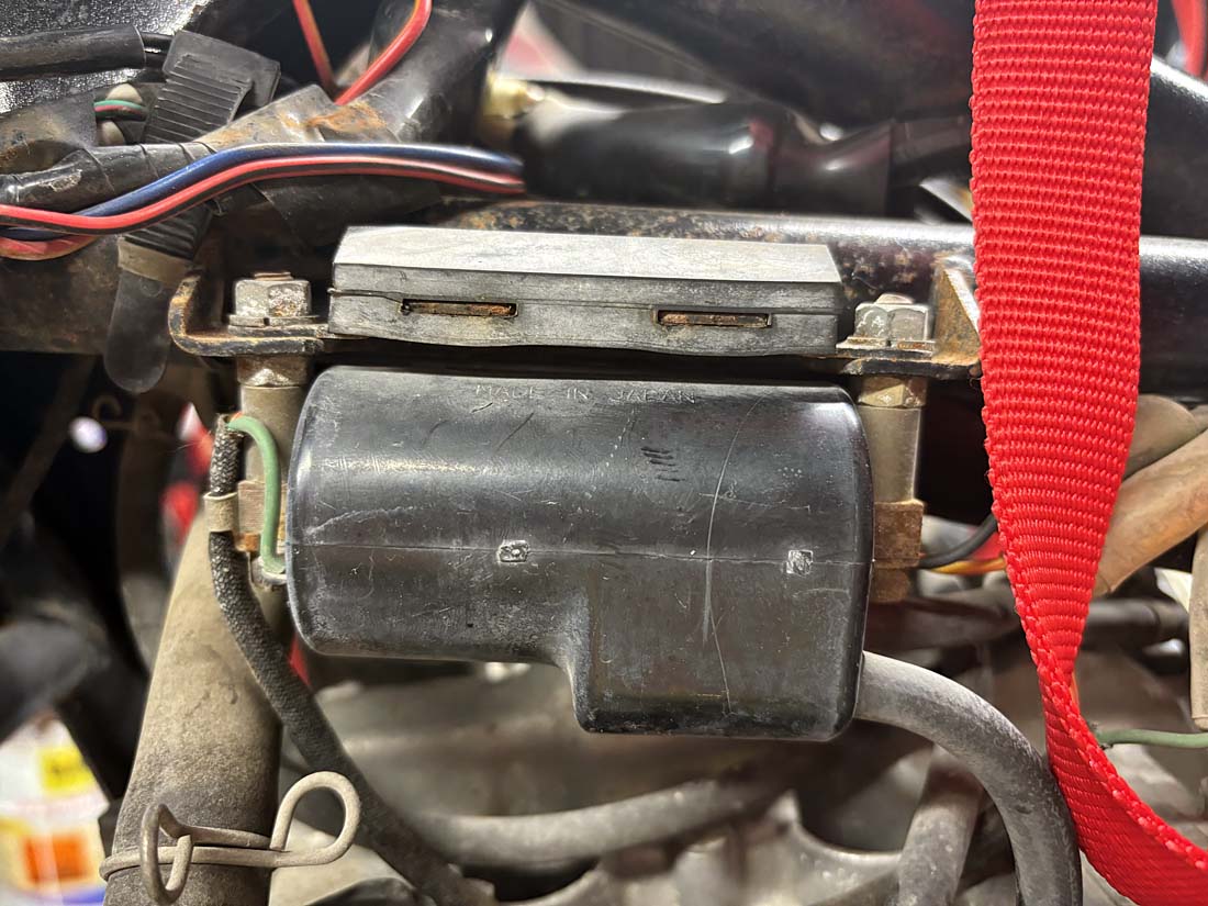

My current project 1978 KZ650SR is moving along. (as I push it)
Carbs are clean and re-installed. Now I need to address the electronics. Key on, known good battery, kill switch on, no obvious hacks in the harness, but ... no spark.
I pulled the cover off and the points look ok.
Suggestions welcome of where to begin probing with my meter or just buy a new set of coils and an electronic ignition ...

Voltmeter on Vdc setting
Red lead to coil feed (yellow/red) black lead to battery ground - ignition on, kill switch on should read within 0.5v of battery voltage
Now without moving the meter leads crank the engine - voltage should drop no lower than 9.5v - 10.0v
Now move the black meter lead to the switched side of the coil - when the points are closed should read close to battery voltage - rotate the engine until the points open - voltage should drop to close to zero (it is the point when you "break the ground" that the coils spark)
If that all reads ok switch meter to resistance, disconnect coils and measure both primary and secondary resistance follow manual for process and spec (I would expect 3-4 ohms on the primary and 10 to 15,000 ohms on the secondary)

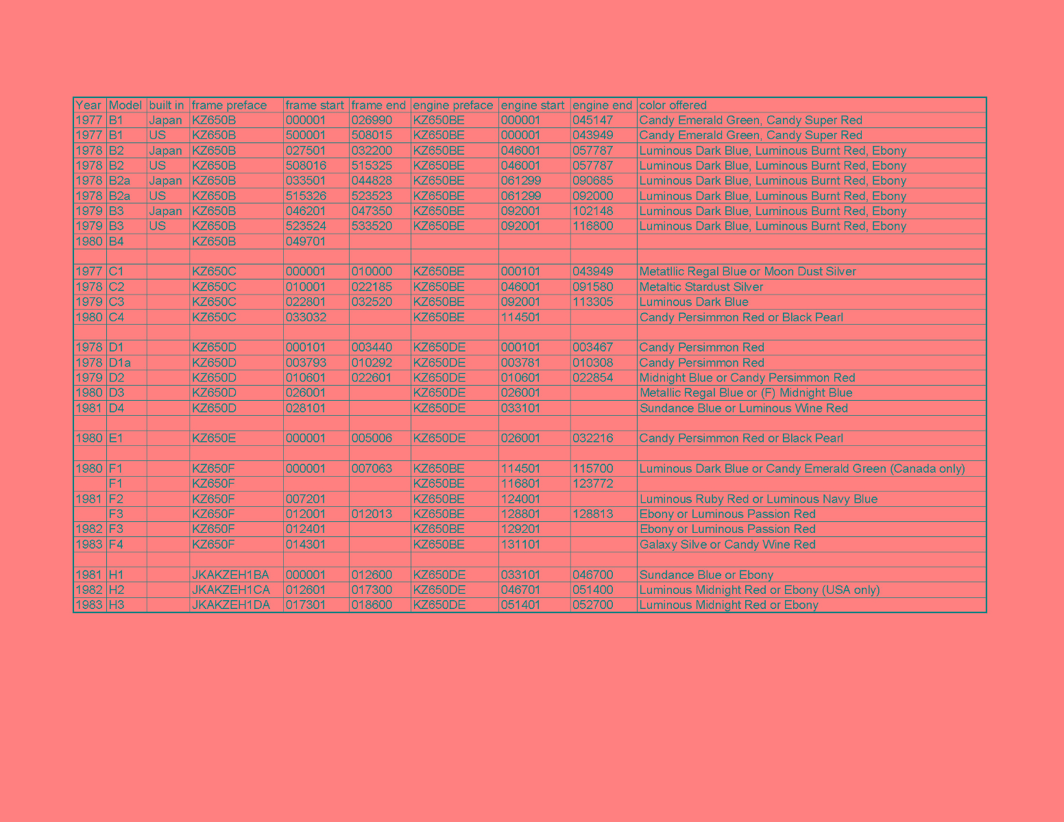

Replied by chopper1963 on topic '78 KZ650SR. No Spark. No Pop. No Fireworks.
How do I discern which model '78 650SR is mine?

Replied by gd4now on topic '78 KZ650SR. No Spark. No Pop. No Fireworks.
The frame number should help with that. Does it still have a white sticker on the neck. If so it should have a month and year build date, if it is a 78 model/year bike it is either a D or a D1A. The D1A came stock with smaller carbs as the major change in the models. Though I will not claim the attached table to be 100% correct here are frame and engine numbers I found in the past. Make of them what you wish.
Sticker on the neck says build date 9/1978.
Frame number: KZ650D-013726
Engine KZ650DE013885
The build date and the frame and engine numbers would make it a 1979 KZ650 D2 and not a year earlier D1 or D1A.
