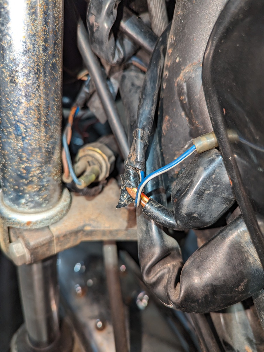

Also seeing these wires on the left side between the tank and fork that seem like that might not be ideal

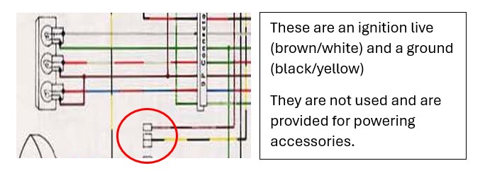

See the below pic for an explanation of the spare wires - now for the "important" bit. do you still have the bulbs out ? schoolboy error on my part (comes from dipping in and out when I'm supposed to be working

Glad to hear the loose wires aren't of concern and I put everything back as I was worried something would get lost or I'd forget what went where so it's all buttoned up but I want to say I tried it on that setting and got similar results. Just slightly different numbers. Is that worth tearing it all apart again?
