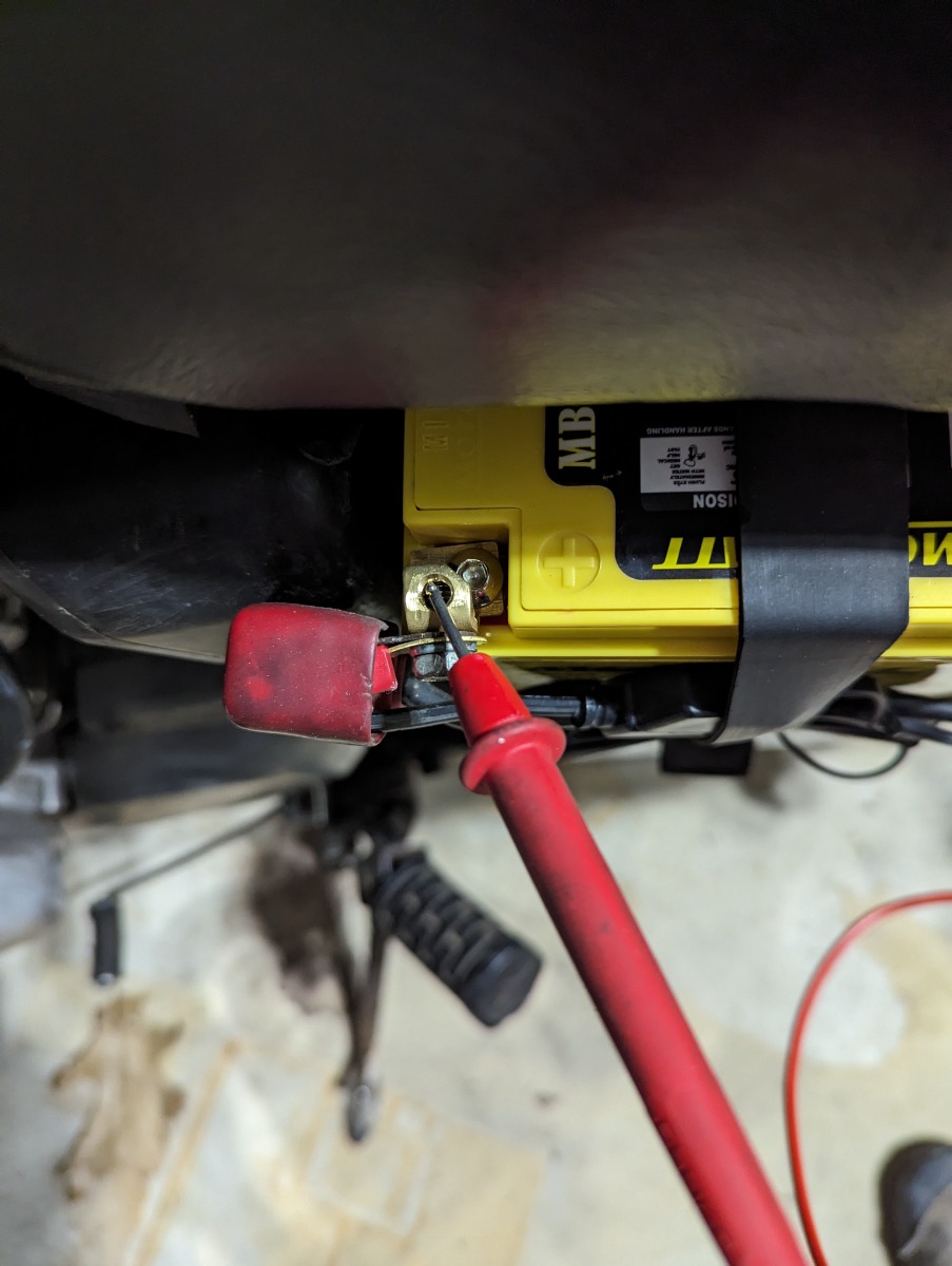

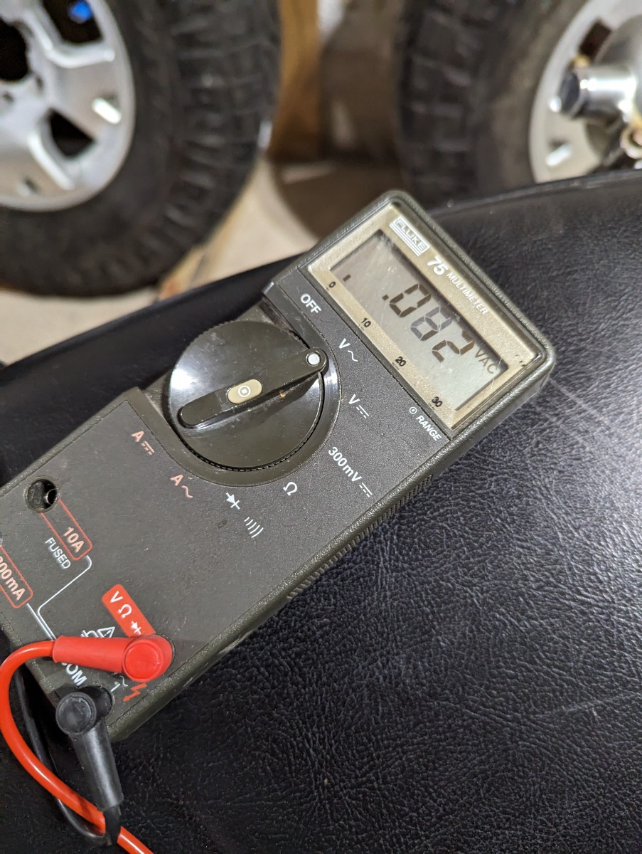

Ok, got all the bulbs out, though getting the cluster bulb was a nightmare and I'm pretty sure I ruined the headlight in the process.
With it all hooked up I'm not getting zero but really close. Key on or off makes no difference. When I flick the blinker it'll spike to something between 25-85 and then go back down to next to nothing. (See pics)

So yes it could be contributing to the issue, it looks like the ground and the red/yellow (headlight low beam) have rubbed through and have been arcing, possible on the edge of the headlight housing. As the US models don't have a light switch this would mean that a partial short here would "load" the ignition circuit above normal whenever the ignition is on. When the flashers are operated this further adds load to the ignition circuit which may be enough to overpower the fuse after a short period of operation. I would suggest separating the other wires in the headlamp and check for further signs of rubbing through (pay particular attention to the green and grey wires). The voltage readings you achieved are minimal 0.08v and may simply be down to a corroded bulb holder etc causing minor leakage.
