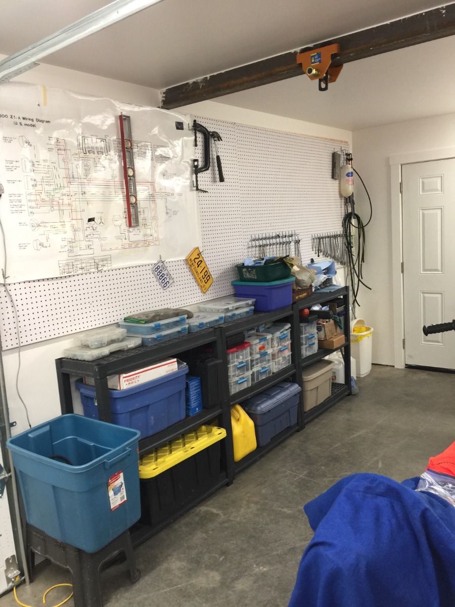

This is my Z1 wiring diagram on the wall of my shop. It's about 3 ft by 5 ft. Easy to see from my lift.

13 Aug 2023 13:46This is my Z1 wiring diagram on the wall of my shop. It's about 3 ft by 5 ft. Easy to see from my lift.
Your shop really does look nice! I'm going to assume that is the only acceptable angle for photography and all of the mess is just out of shot.
I like the roller/hoist device on the RSJ - that looks handy. I'm tinkering with a design for a hoist frame that is self-supporting but uses the floor joist above for lateral support (i.e. to stop it tipping over). It's impractical to leave it in place all the time but it would be nice to set it up for the rare occasion I need to pull/install an engine or something.
