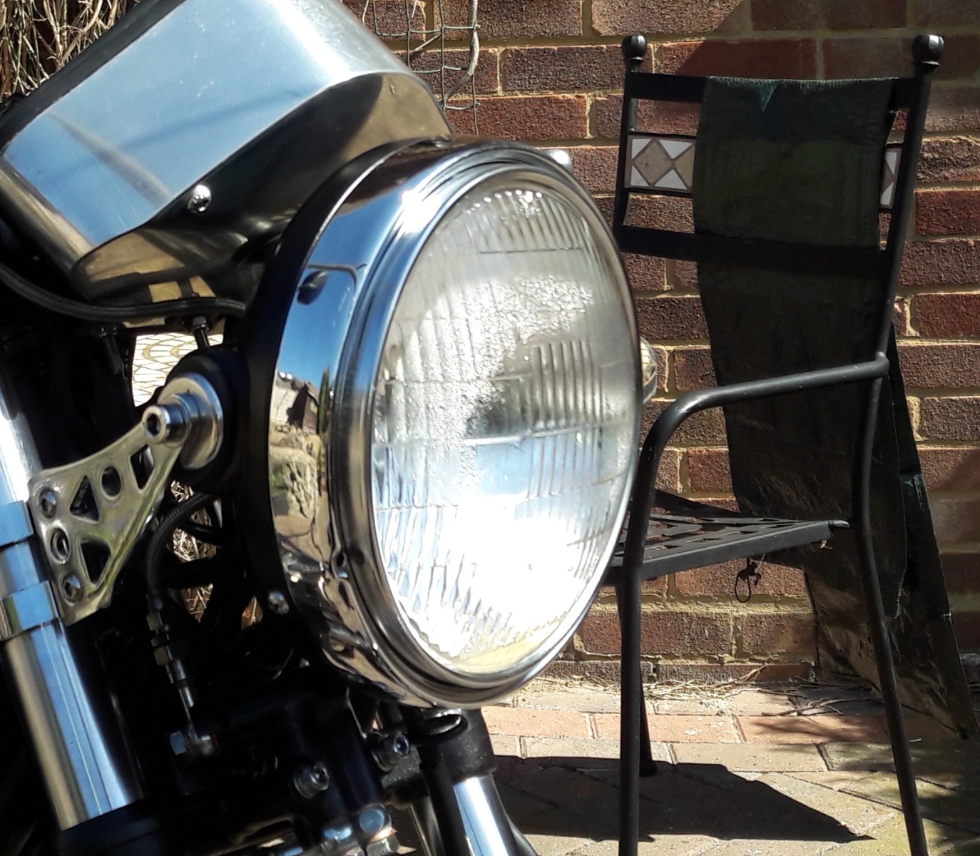

Re: KZ400 Position Lights
24 Nov 2022 23:54
Trust me, it'll fit perfectly. I've used them on several restoration projects. The black 650 below has one fitted which is an American bike I imported into the UK.
