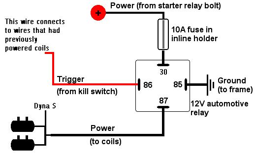

What voltage do you have at the coils. If below battery voltage might be prudent to do the wiredgeorge relay mod.

The by-pass relay is a good shout if the voltage is low at the coils ( a lot quicker and cheaper than tracking down lot's of small losses which add up to a big one) if the voltage is ok something else that might be worth checking (I don't know if it is relevant to your set-up)

Very good point re the coil modincluded is a pdf of that mod i did to the Z500 was loosing quite a bit of voltage thanks to the std thin wires.

Thin wires don't help but age is the key problem. The coil feed on most of these bikes runs through several components and connectors. Over time as corrosion takes hold you get resistance. If you loose 0.2v (which is no big deal) at each of the seven or eight junctions you are now loosing 1.4v which is a big deal. These issues sneak up on you over time

4 ohms at 12.7 volts will draw 3.175 amps ( 40 Watts) whereas at 14.5 volts it will draw 3.6 amps ( 52 Watts) so you get more energy to saturate the primary coil, so more energy in the spark when the points open.
Place you volt meter in DC volts one probe on the + bat terminal and the other on the coil wire (Red-Yellow??) not he neg coil wire (black-wire??) and turn the ign on with kill button on run and see what voltage is dropped with the coils powered any more that 1.4 you prob get a weak spark. you can do this engine running too (prob better)

So it looks like the supply voltage is all good (unless it drops like a stone when cranking the engine) You can connect the voltmeter red lead to battery positive and black lead to coil feed wire then crank the engine, you are looking for no more than 0.5v as you are measuring the difference between the coil and the battery.
