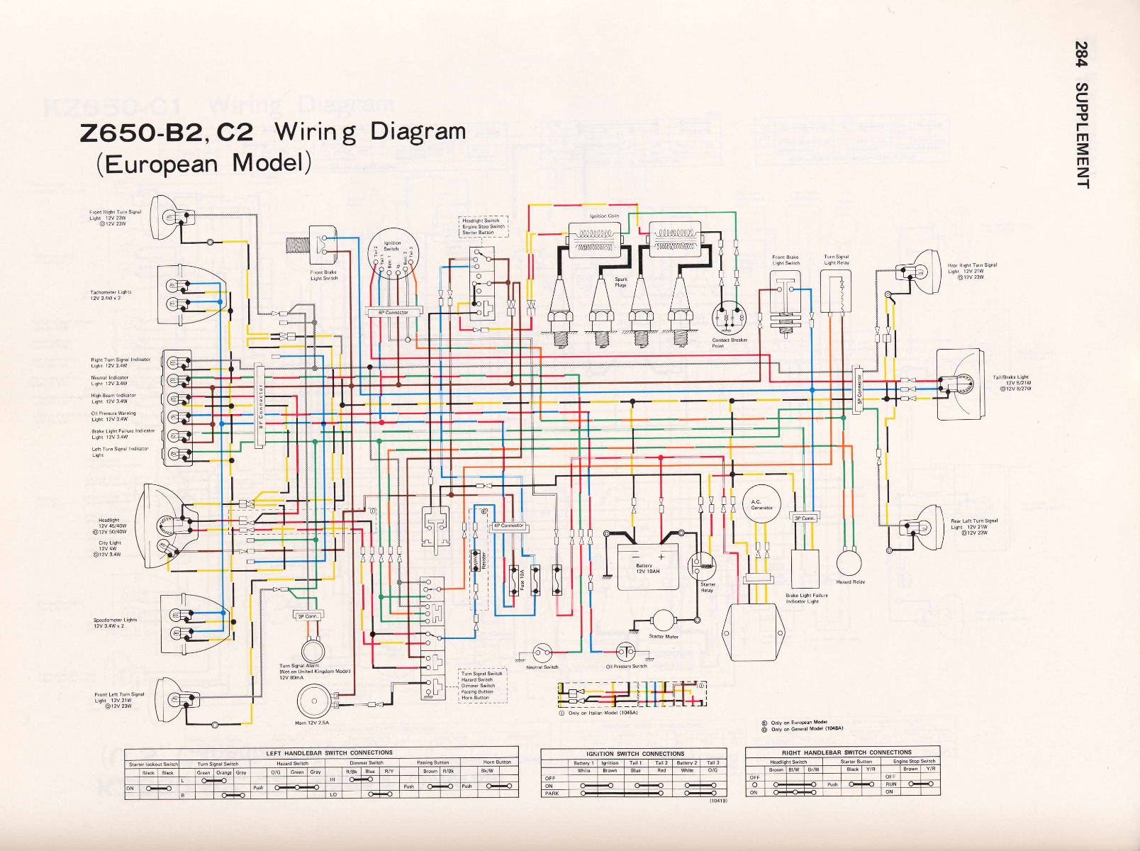

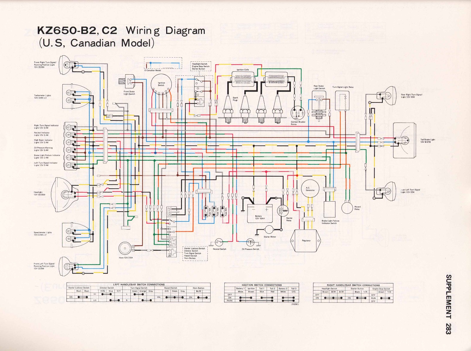

You indicate you have a 78 KZ650 B2 here are wiring diagrams for the North American model and the European model.

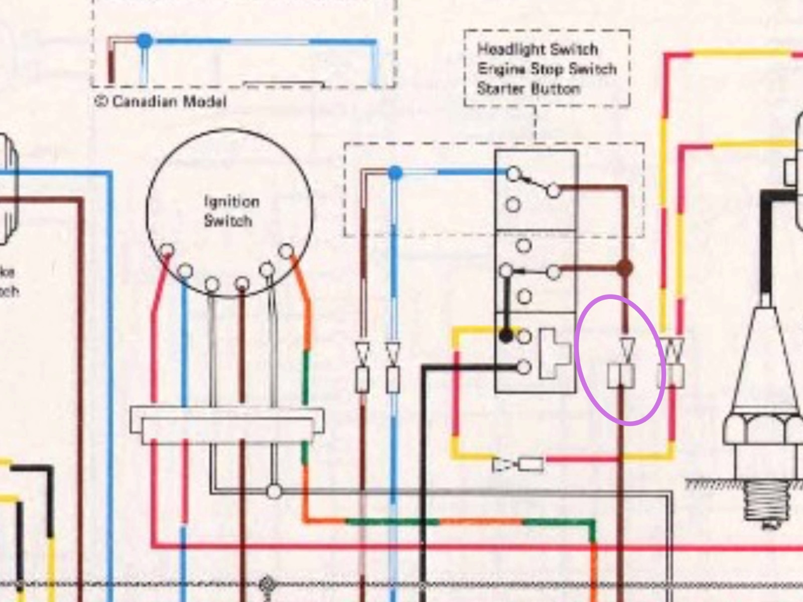

Hi Andy, I have had a look at the wiring diagram kindly provided by gd4 and I think you have two separate issues which should be quite straight forward to sort out.
The main problem seems to centre around the right handlebar switch as this controls the starting and also provides the feed to the two 10a fuses.
Blue/ White and also Brown/White are the feeds to the fuses so are "outputs" from the switch
Red/Yellow is the feed to the ignition coils so is also an "output" from the switch
Black is the feed to the starter via the lockout switch (I am guessing this is on the clutch lever) so is also an "output"
The Brown is the feed into the switch which powers all of the above
WHEN TESTING VOLTAGE CHECK THE BATTERY VOLTAGE FIRST -ALL READINGS SHOULD BE WITHIN 0.5v OF THE BATTERY VOLTAGE
With everything connected and the ignition switched on, test the voltage on the brown wire going into the switch (I have highlighted the connector on the diagram as I suspect this is corroded which is the cause of the problem)
If the supply voltage going into the switch is ok then check the output voltages ref the above list
Red/Yellow - test with the kill switch in the run position
Blue/White - test with the headlamp switch in the "on" position
Black - test with the kill switch set to "run" and the starter button pushed
With the indicators - these are independent of th above, check the output voltage from the ignition switch on the Orange/Green wire which feeds the flasher units for both indicators and hazard lights
Happy hunting

Was it me who said this should be straightforward ( that put the kiss of death on it !!) couple of questions
Red/Yellow
Blue
Blue/Red
What looks like pink (is that white)
If the wires in the picture are from the switch I can't see where the red and black are going in the switch (the red appears to be taped up as if it isn't in use ?)
The pink (or white) appears to be the feed in (brown originally) going to the kill switch along with a red/Yellow which appears to go to the starter button (are there two Red/Yellows going into the sleeving from the switch and joined together)
Does the Black go to the starter button next to the Red/Yellow
It looks like a Blue - Blue/red - white (pink) going to the lighting switch - is this correct
Once you clarify the above we should be able to work out what is going on (more pictures of the inside of the switch would be useful)
- Does the light switch have two positions (parking light & headlight)
- ref the picture below, are these the wires coming from the switch ?
Red/Yellow
Blue
Blue/Red

Ok here we go -
Pink goes to Brown
Red/Yellow goes to Red/Yellow
Black goes to Black
Blue/Red goes to BrownWhite
Blue goes to Blue/White
Red not required
In this configuration when the light switch is in. The "PO" position it will feed one of the 10a fuses that powers the panel lights and front marker lights (in the front indicators)
In the "On" position it will also power the second 10a fuse that powers the headlight via the Dip/Main switch on the left handlebar switch
So back to testing:
With ignition on Pink wire should have battery voltage going into the switch
Kill switch in "Run" position Red\Yellow should have battery voltage coming out of the switch to power the coils
Kill switch in the "Run" position, push starter button Black wire should show battery voltage coming from the switch to feed the starter solenoid
Ign on, light switch in the "PO" position Blue/Red wire should show battery voltage coming from the switch to feed 10a fuse
Ign on, light switch in the "On" position Blue wire should show battery voltage coming from the switch to feed the other 10a fuse
Take all voltage readings with the black meter lead connected to battery negative terminal
Happy hunting (take 2)
