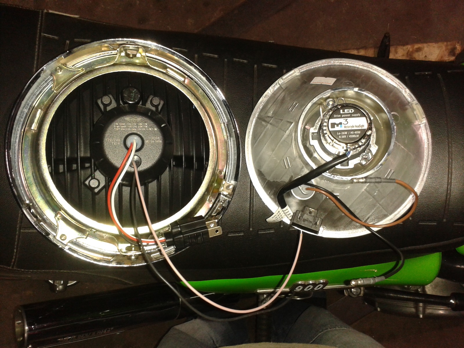

I did a headlight conversion. You need a 7" LED head light insert. My HIGHSIDER LED insert fits plug and play into a Z1 or KZ1000 head lamp housing.

Most replacement assemblies have an H4 plug (including the one you have linked), and are just a straight swap provided you get the correct size. I don't know of any that keep the small accessory bulb, so you will lose that. But the link you have has a separate halo ring, so you could potentially wire the accessory bulb to the halo ring.
The biggest problem will likely be clearance, not wiring. The headlight lens cannot be too deep as there is a lot of wiring stored between the lens and the chrome bucket. Before ordering anything, check the depth and make sure it's no deeper than the stock headlight. Most LEDs will likely be more shallow, buy you won't know unless you measure.
So check dimensions (diameter and depth), and if it's an H4 plug it should be a straight swap (presuming KZs have H4 bulbs - I know many cars of the era didn't in the US but did everywhere else).
