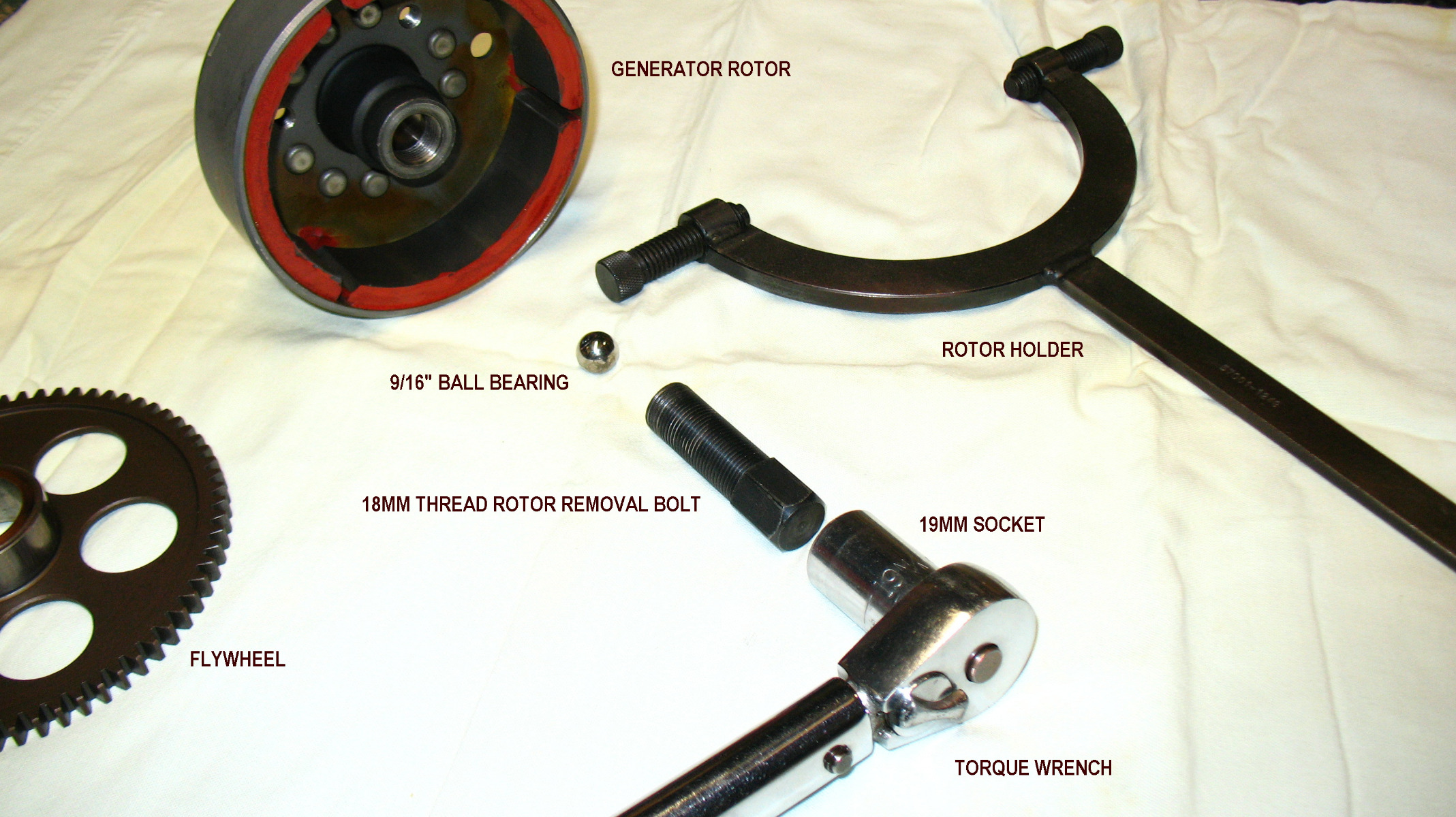

IMO, study the Kawasaki Factory Service Manual on this subject before proceeding.  Use tools made for the job, and do not waste a penny on alternative methods.
Correct tools make this job simple by comparison, and the potential for damage is minimal.
Tools I find useful:
1982 KZ1100-A2 bike
1984 ZN/ZX1100 motor
Last edit: 06 Nov 2021 22:35 by daveo.

Just looked up the rotor holder tool on ebay... the only one I can find is NOS, for like $200 plus shipping! There are cheaper "universal" ones that claim to fit the bike, but they look entirely different like this  www.z1enterprises.com/yamaha-xs650-clutc...et-holding-tool.html Would that be an acceptable substitute? I don't see how it would work anything like the one you showed, but I've only ever even been in this part of the police version of the J model engine once to replace the stator (bigger stator than the standard J stator, and I know this cuz I bought a J stator and it was smaller than what was in there, so I had to buy a second, police version). I just don't think I can get the money for the OEM tool saved up before it disappears from ebay.
The removal tool isn't too badly priced. Is the Motion Pro one ok? www.amazon.com/Motion-Pro-08-0116-Flywhe...ternal/dp/B009J7O7J0
