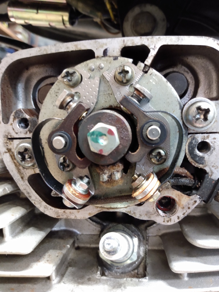

Here is a pic of the points and timing plate on my KZ305. They were adjusted with a dwell meter and timing light a few month ago.
Do not try to adjust timing untill point gap is right. (.3mm - .4mm at its widest spot)
Note where the timing plate notches are in referance to places on the head cover.

Thanks for the pic, its another piece of the puzzle. I checked my disassembly photos and found one of mine and it was in about the same position.
But I knew something was very wrong here, because after setting the gap the points seemed to behave exactly the opposite of how they should behave. I could not get the left side points to be anywhere near the "barely open" gap they need to be near TDC, no matter how I adjusted the timing plate. In fact it did seem, in hindsight, that they were very near the widest gap near TDC. That gave me an idea.
I took off the whole thing and removed the cammed sleeve on the governor (can't find that part's name on Partzilla). I rotated it 180 degrees.
Boom. Duh. That was apparently the problem. Now I'm in the ballpark but I gotta go to work now.
