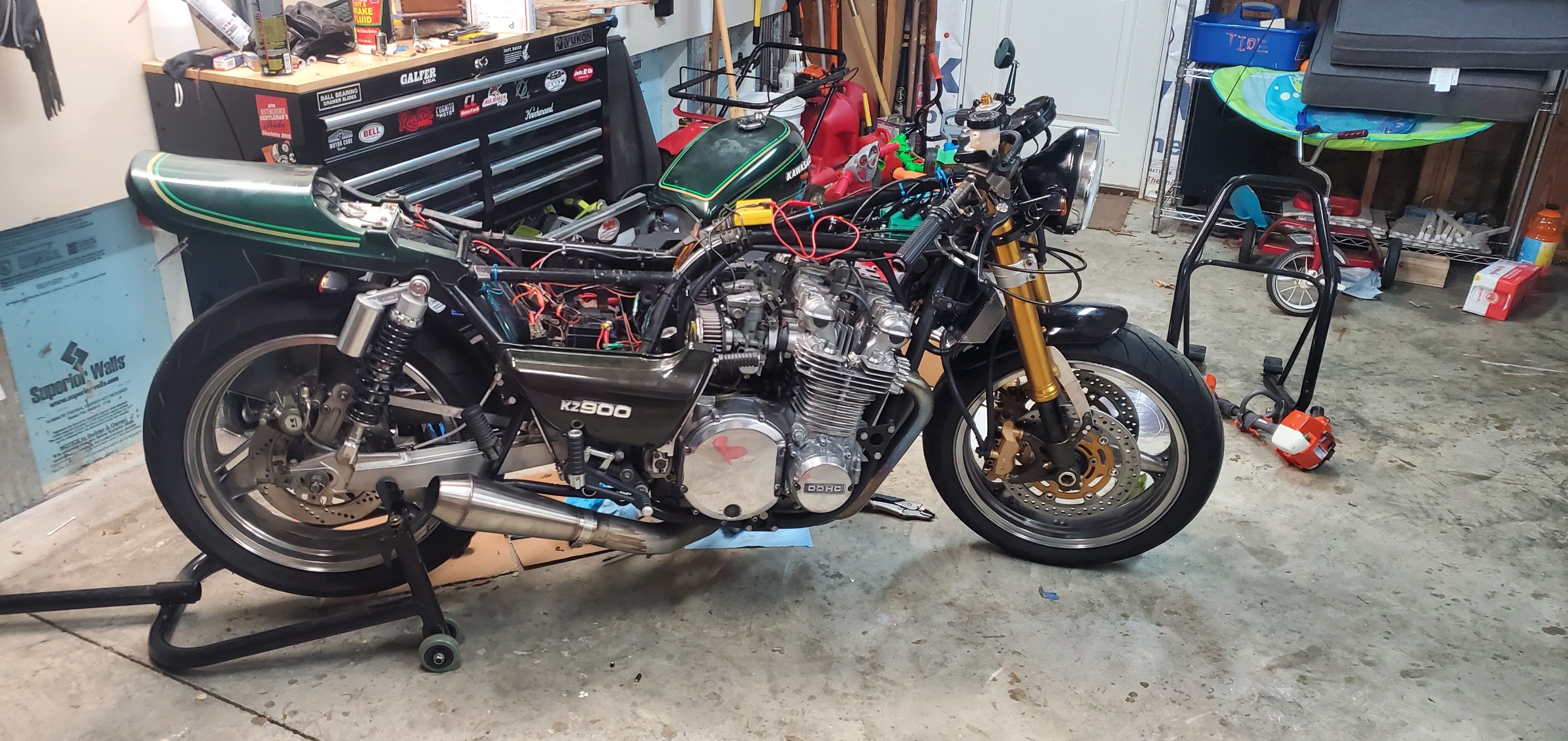

77 KZ900. Runs great for 200 miles then runs like shit. This time I limped home after dropping 2 cylinders (new plugs) and they looked brand new when I got it home. Measured voltage at coil for 2&3, 8.3 volts. Coil 1&4 had 8.9 volts.
I have a Dyna-S ignition, new run/stop RH switch, motogadget m-lock, new green dyna coils, new 7mm suppression wires, new blade style fuse holder.
I did the wired george mod and do have an improvement in volts to the coils, but not full battery voltage. Battery voltage w/ key on, switch in off position is 12.6, and w/ switch in RUN position it is 12.2. Measured coil voltage and I get 10.5 volts.
Should I be concerned that I'm not getting 12.2 volts or be happy I have 10.5?
