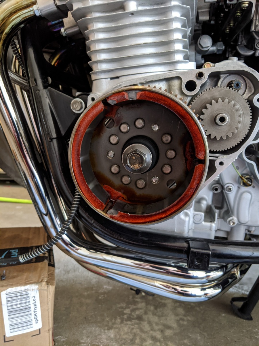

I doubt it. :whistle:

If the magnets are not chipped or cracked you may be ok. From my experience with that issue, the missing stuff has migrated to the bottom of the oil pan.
