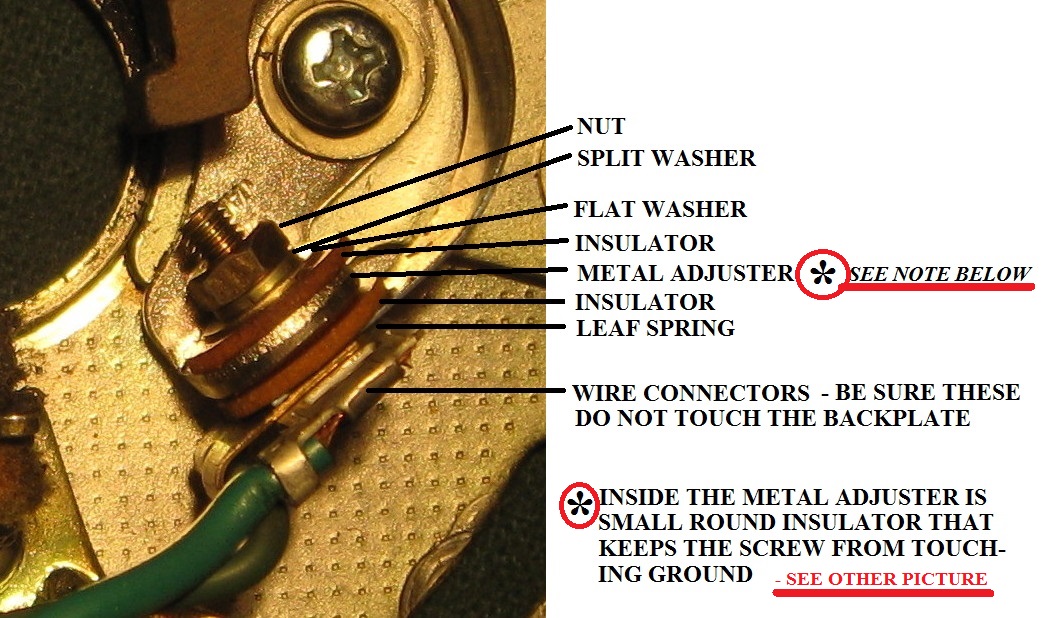

Did you set the GAP first? If not, that may be the problem..........
Before attempting to replace or adjust the points the following is important to understand; timing is comprised of two separate components, and BOTH of these components MUST be set properly if the engine is to run well:
--- The GAP – this is the distance the points spread apart when fully open. This is set by adjusting the points. The GAP is the element that determines the DWELL. In essence, the DWELL is the number of degrees of points cam rotation that the points are closed and this controls the amount of time the coils receive a charge before firing the spark plugs.
--- The TIMING of the initial opening of the points (the point at which the continuity across the points breaks) controls the precise instant that the coils receive the signal to fire the spark plugs. This is set by turning the backplate AFTER the gap is set.
