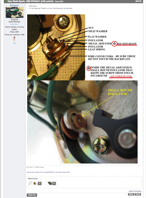

Re: Spark Plug Gap
22 Jul 2020 18:13 - 23 Jul 2020 10:02
meter time.
points closed
ignition on/engine off
DC Voltage
black meter probe on negative battery post
red meter probe on positive coil terminal
note voltage
red meter probe on negative coil terminal.
note voltage
rotate engine till points are fully open
black meter probe negative terminal
red meter probe negative coil terminal
note voltage
note voltage
Turn off ignition
This may be contributing to your woes. Here's a post from Scirocco:

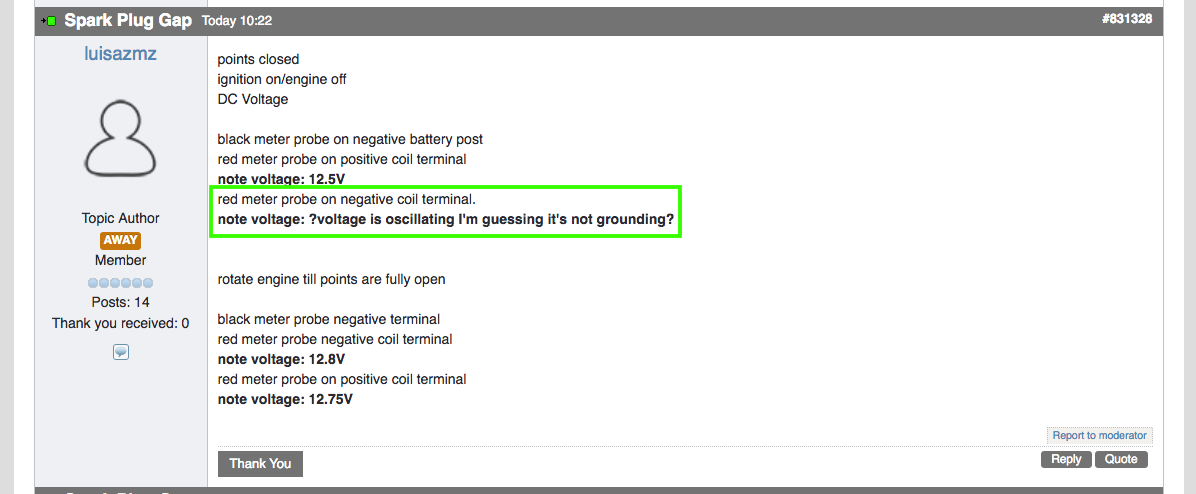

Re: Spark Plug Gap
24 Jul 2020 07:22
points closed
DC Voltage
note voltage: 12.5V
note voltage: ?voltage is oscillating I'm guessing it's not grounding?

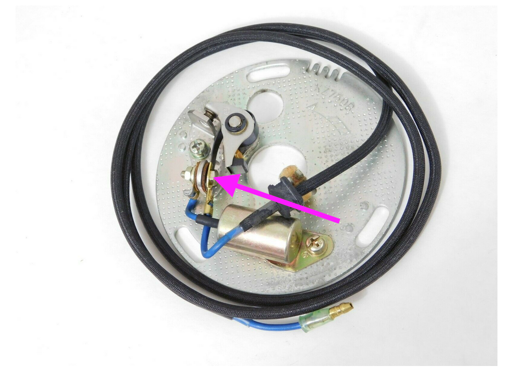

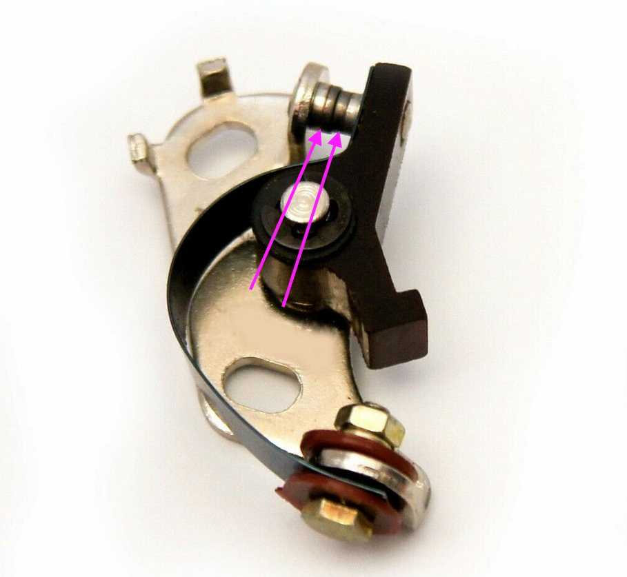

Re: Spark Plug Gap
24 Jul 2020 09:46 - 24 Jul 2020 10:12
Yeah, it doesn't appear you are fully grounding with points closed.
dc v
points closed
black meter probe negative battery post
red meter probe positive battery post
note voltage
move red probe to each contact on the points(pink arrows)
note the 2 voltages
move the red probe to the case of the condenser
note voltage
turn off ignition
You want both of the voltages on the contacts to be close to 0 volts. There should be 0 volts all the way back to the negative coil terminal.

Re: Spark Plug Gap
24 Jul 2020 16:56 - 25 Jul 2020 07:47
This is the one reading that is throwing me off.
i'm going to have you follow the points wire back to the coil.
meter dc v
points closed
black probe on negative battery post
red probe on terminal with the pink arrow
note voltage
move the red probe to the negative coil terminal(the metal piece coming out of the coil not the connector on the wire)
note voltage
These two readings should be the same--close to 0 volts.
If not there is a problem on that wire.
Turn ignition off
If possible, send a picture of your points plate
