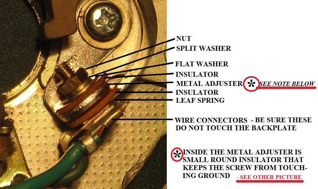

Re: Engine turns over, no spark still
28 Jun 2020 08:34
Thanks to all for the added info here on this subject. The pics really helped to clear up what was being said/explained. I have always been a "visual" leaner.
