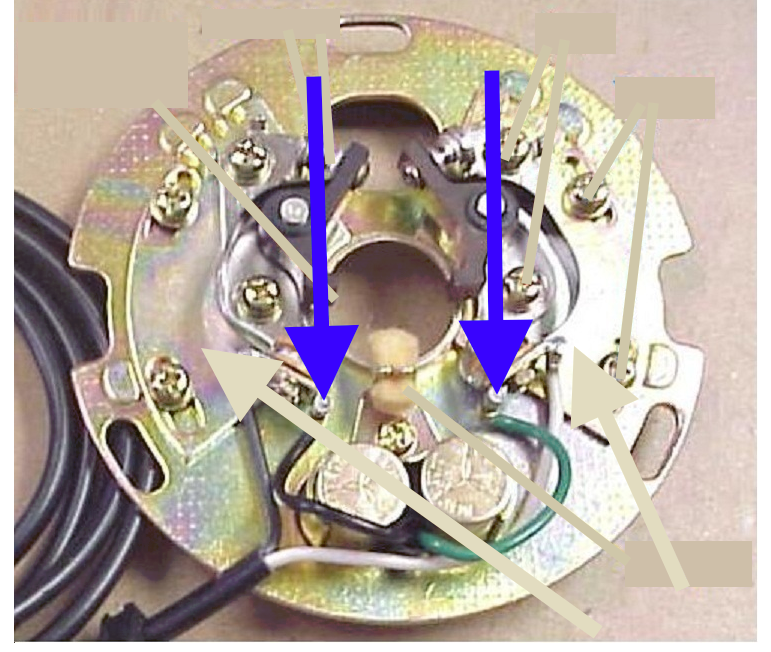

When I check the points plate I am getting 16.8mV

ok
so your ground on your points plate is good.
Ignition on
Move your positive meter probe to these wires.
When you got the 16.8 mv, was the ignition on?
Ignition on

Re: Engine turns over, no spark still
27 Jun 2020 16:18Yes, the ignition was on. For the other two wires I got 12.56v on both

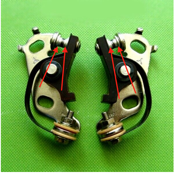

before the next measurement.
get a small file and sand your point contacts

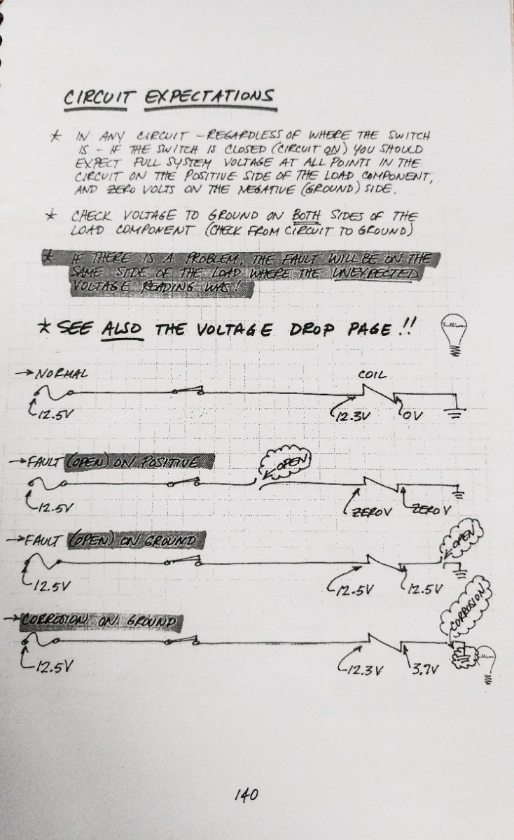

Rick,
This is where I learned a bit more of troubleshooting.
Dan Sullivan's
Fundamental Electrical Troubleshooting.
Dan Sullivan's

27 Jun 2020 16:26F64 wrote: before the next measurement.
Ok, my points are brand new, should I still sand em down a bit?

27 Jun 2020 16:35
yes, lightly and clean with alcohol.
27 Jun 2020 16:50
Be seriously gentle “filing” points... I’d check them first for pitting... if they are smooth and not pitted you not gaining anything... actually you be changing the gap and starting another issue
27 Jun 2020 16:51 - 27 Jun 2020 16:53
Ignition on
points closed
20v DC scale on meter
negative meter probe on negative battery terminal
positive probe on each of these points
points closed
27 Jun 2020 16:58Mikaw wrote: Be seriously gentle “filing” points... I’d check them first for pitting... if they are smooth and not pitted you not gaining anything... actually you be changing the gap and starting another issue
Mikaw
The points are new.
I'm eliminating the possibility of a coating or residue on the points.
There is a break in the circuit between the points plate and the wires going out to the coil.
