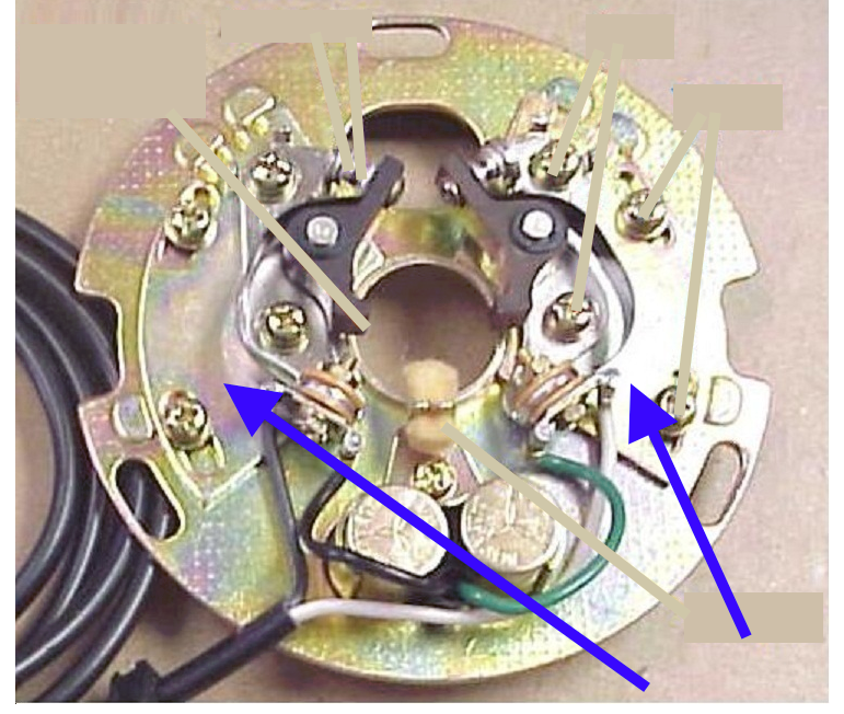

The points wire is fine.
Move the positive meter probe to the points plate.
Negative probe on negative terminal
photo: Patton
photo: Patton
