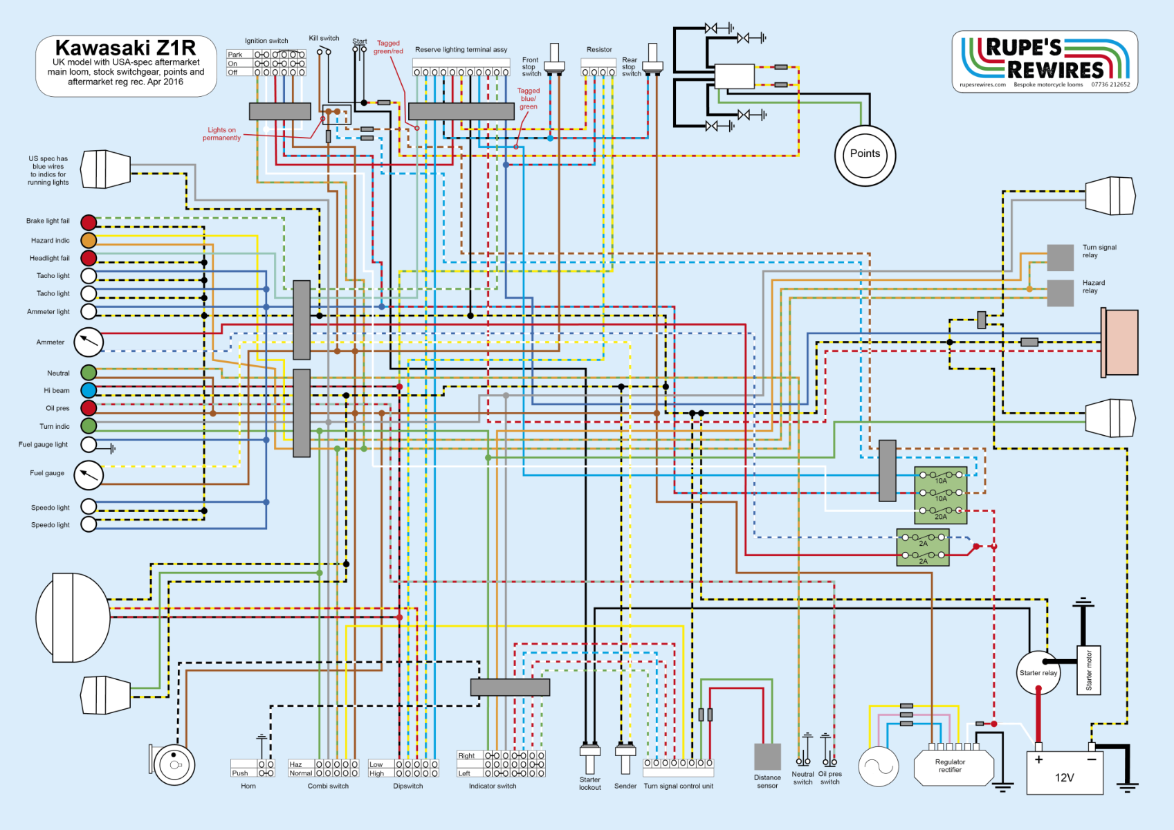

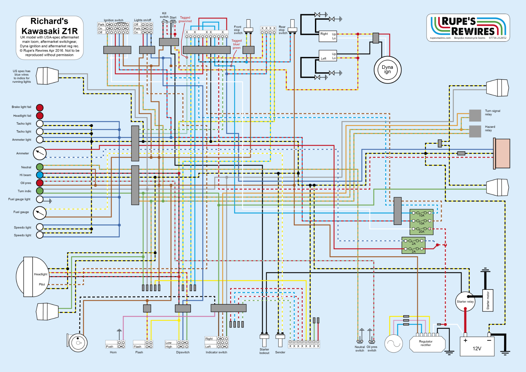

Here's a wiring diagram from the Kawasaki FSM. Open image in new window to enlarge.
...1978 KZ1000-D1 (Z1-R) wiring diagram

That last diagram is the correct one to use. The one that says (US, Canadian model).
Looking over the diagram, it looks like you can't remove the reserve lighting box. The headlight power passes through this box on the way to the hi/low switch. However it does look like you can disconnect the resistor pack that is also part of this system. That would prevent the reserve lighting box from sending power to the high beam filament when it detects a fault.
This resistor pack is mounted under and between the two coil packs. There is a connector right on the pack. Unplug this connector and the reserve lighting system should be disabled.
Although there is some chance that your tail light might stop working. I can't tell as I don't know what logic or connections are inside the control box. But the stop/tail light is connected directly to the reserve lighting box, so who knows.
If disabling the reserve lighting helps your problem, you may be able to remove reserve lighting control box by buying the correct mating connector and creating a jumper plug. Many of these connectors and contacts are available.
