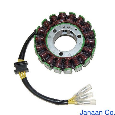

Hi Guys,
So I have a new problem with my 1979 kz650. This time it's a bad stator. There are however so many type of stator on the market that I don't know which one to use or if they're interchangeable. Could anyone provide me with a list or even better, following websites where I can buy a compatible stator for my kz650? My model is 1979 Kz650-B3, the mechanic says the stator should be two phase. Thanks a lot.

There is no 2-phase stator on Kz's.
Two-wire is 1-phase.
Three wire is 3-phase.
Yours is originally 1-phase.
You can use a stator from any Kz650 that uses a permanent-magnet flywheel which is any model after 1977. After 1979 they went to 3-phase, and you can still use those stators, but will need a 3-phase regulator/rectifier. You can also use the stators from inline-four cylinder Kz750's (but not the twins). They are 3-phase and will also require a 3-phase reg/rec.

You state "the mechanic says the stator should be two phase."
As loudhvx stated the bike did NOT come with a 2-phase stator. The 1979 KZ650 came with a 1-phase stator. You may want to find a "mechanic" that has a better understanding of things - I know I would! Ed

Your bike has a stator under the left side engine cover. To remove it, you simply remove the cover and unbolt 3 bolts. Your stator is 1-phase which has two yellow wires. It has 12 pole pieces which look like "spokes" of a wheel.
You will find one from a Kz650 or Kz750 which has three yellow wires and looks similar, but has 18 pole pieces or "spokes". You will find them on some/all Kz650 from 1980 and later. Or you can find one from a Kz750 four-cylinder from any year.
You can also buy an aftermarket stator for one of those later bikes.
Your flywheel which has the magnets on it should fit fine with the new stator.

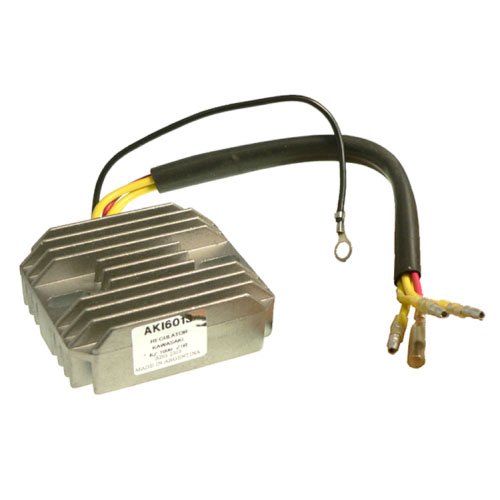

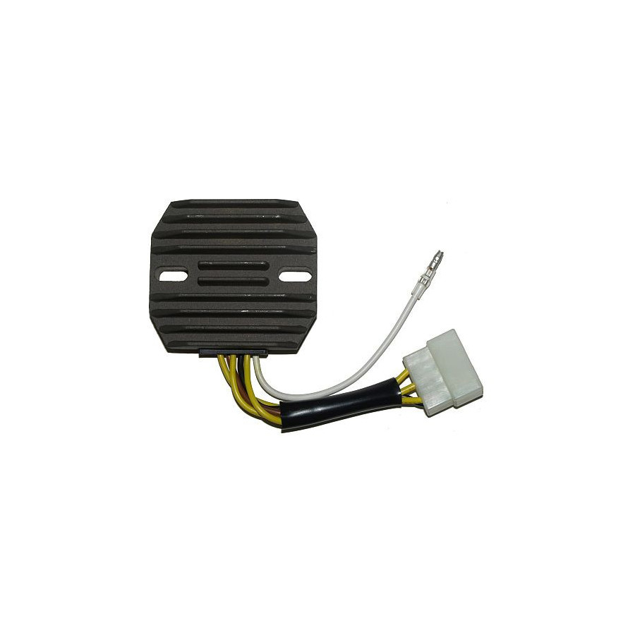

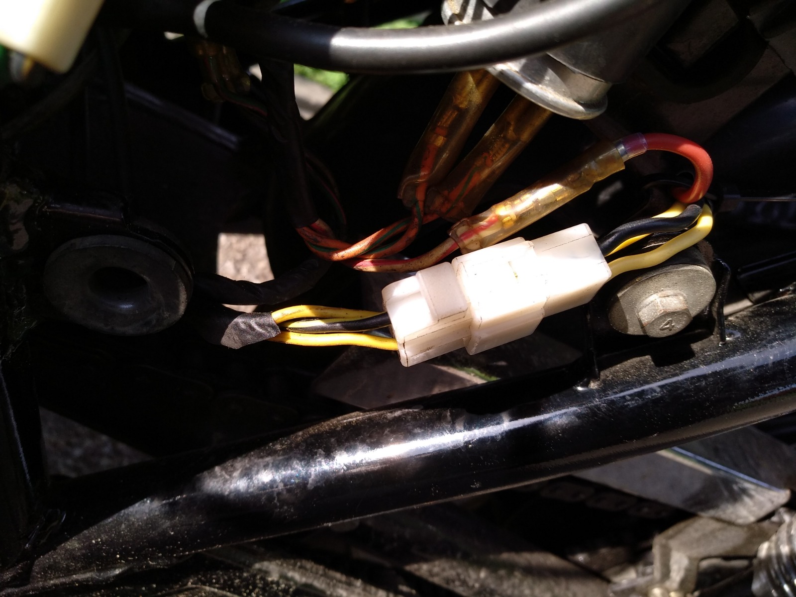

Hi, so this is how I am understanding it (Also attached pictures to see if I'm correct). I got the stator. The, I got the regulator, in which I am not sure which one is correct. Please help me check if any of the following is the correct one that I can use.:
1. The three yellow on the new stator will go within the side cover and connect with the 3 yellow on the regulator.
2 The brown wire on the regulator will go to the red-white stripe wire from the motorcycle.
3. The black wire will connect to the black wire
Please help me check if my understanding is correct and which regulator i will need. Thank you so much.

I think #2 is wrong. But I will have to check the wiring diagram.
If you get a regulator rectifier with 5 wires and it has 3 yellow wires, and one red/white, and one black for a Kz650 or Kz750four, then you don't need to worry about the brown wire.
You still have to add the yellow wire.
I can make a simplified drawing when I get a chance.

If I'm guessing correctly, i should use the 3rd rectifier one yes? the shiny silver one, then the 3 yellow wire will connect with the 3 yellow wire from stator, then the red wire from the rectifier connect to the red stripe wire from the bike. then the black ring wire go straight to the battery. Right?

It's hard to judge which would be best from photos since I don't know what the photos are actually of. But it appears to have the correct wire colors. Was there a listing of what it is, or where it is available?

No eBay APP ID and/or Cert ID defined in Kunena configurationAlso, I've looked at the 79 diagram for a C3 and another for a D2. Your #2 statement above should be to connect the reg/rec brown wire to the brown wire of the ignition switch, or the yellow wire of the ignition switch. Not red/white.
This is the only type of thing I've had experience with and so far I've been lucky. Every one I've bought has worked fine.
OregonMorotcycleParts.com has been very reputable and has a good warranty.
They have the VRRPM3 which is probably the one you want. It does not require a brown wire.
Red goes to battery. Black goes to ground.
