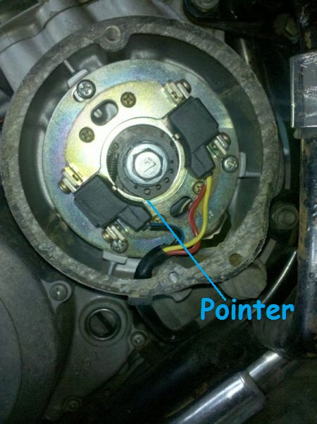

Many Kawasaki models with a stock points ignition later evolved to an electronic ignition that included pick-up coils under the points cover together with a separate part called an I C Igniter which was located somewhere else such as underneath a side cover.
The pick-up coils have a pointer similar to the following:
The I C Igniter looks something like the following:
Not saying that it happened here, but sometimes a Kawasaki electronic ignition (pick-up coils and igniter) is mistaken for a CDI (Capacitor Discharge Ignition) or mistakenly referred to as a CDI.
I'm unaware of a stock Kawasaki street model in the 1982 era that came with a CDI, but maybe the bike came with a points ignition that's been replaced with a Kawasaki electronic ignition (pick-up coils and igniter); or possibly an aftermarket CDI was available and installed on the bike at hand; or maybe a CDI from some other Kawasaki model was installed on the bike at hand.
I think it would be helpful if you could you post a pic of the ignition that's reported as faulty and a pic of the new but non-matching replacement.
Meanwhile, I don 't see any reference in the posted Factory Service Manual to "CDI" or to "Capacitor Discharge Ignition."
