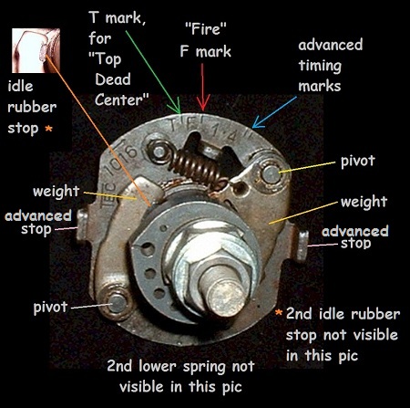

No eBay APP ID and/or Cert ID defined in Kunena configurationThe timing advancer in the listing has 1025 stamped into it, so I would assume 1025 is the last 4 digits of the part number for that advancer. Because every advancer I've seen for electronic ignition has the last 4 digits stamped into it. Also, the advancers in the parts diagrams usually have the prefix 21148, so I would assume the part number is 21148-1025, but Partzilla does not recognize that number.

For some reason, I couldn't make out the number in the photo. It should have "1016" stamped on it like this one.

Good catch Martin! I was able to get the zoom to work this time and saw the "1025" stamp.
21148-1025 appears to be for a Zr400, so I would not use that on a 550.
Look for 21148-1016 to use on your Zx550.
In addition to the one Martin posted in New York, you should be able to find them in Europe.

Yes. I've noticed that. Already asked the question to the seller.
martin_csr wrote: The timing advancer in the listing has 1025 stamped into it, so I would assume 1025 is the last 4 digits of the part number for that advancer. Because every advancer I've seen for electronic ignition has the last 4 digits stamped into it. Also, the advancers in the parts diagrams usually have the prefix 21148, so I would assume the part number is 21148-1025, but Partzilla does not recognize that number.
.... pic #6 >> 21148-1016
