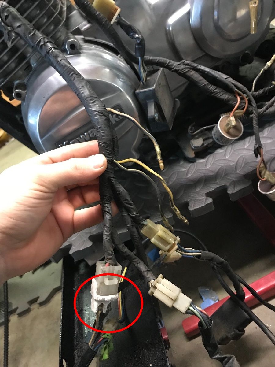

Have you used the old or the "new" wiring harness?
Some connectors need to be replaced!!!

Now it’s working. I’m trying to post a video. Anyway I got the lights working. But I’m not sure where the second red and white power wire goes. There isn’t any plugs for it. All I got is the one from the fuse box to the positive cable on the starter solenoid.
The other red/white wire doesn’t go to the regulator. I mean it probably has a power wire going into it buy its not from one of the two power wires from the starter solenoid.
Thanks! I tried posting a video but it won’t let me.
