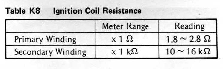

I thought the stock 750 coils were 2.4 ohms and they definitely have points ignition. Or are they 4 ohm? Anyone know the specs on stock coils? And Id get Dynas, but alot of messing around that I'm already sick of right now. There's alot of quality stock type replacements in which I think I may do for this bike. Just need to know exactly the ohm resistances that will without a doubt work. When I find the kz1000 I'm looking for, definitely go all out on that though.

- jenningsjesse
- Posts: 101
- Thanks: 6
Re: 81 Spectre 750 coil replacements
28 Jul 2017 06:49
Thanks. Was thinking I needed 2 ohm coils not 3 or 4.
