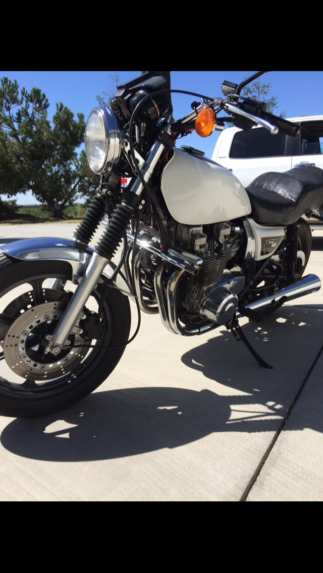

14 Jun 2017 20:36
Nice bike!
The pooch...
The pooch...
