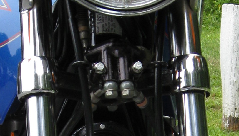

Not sure if the is the correct forum but looking at the pictures below I can't seem to find the front brake light switch. So that got me wondering if this is the correct MC for my kz750H

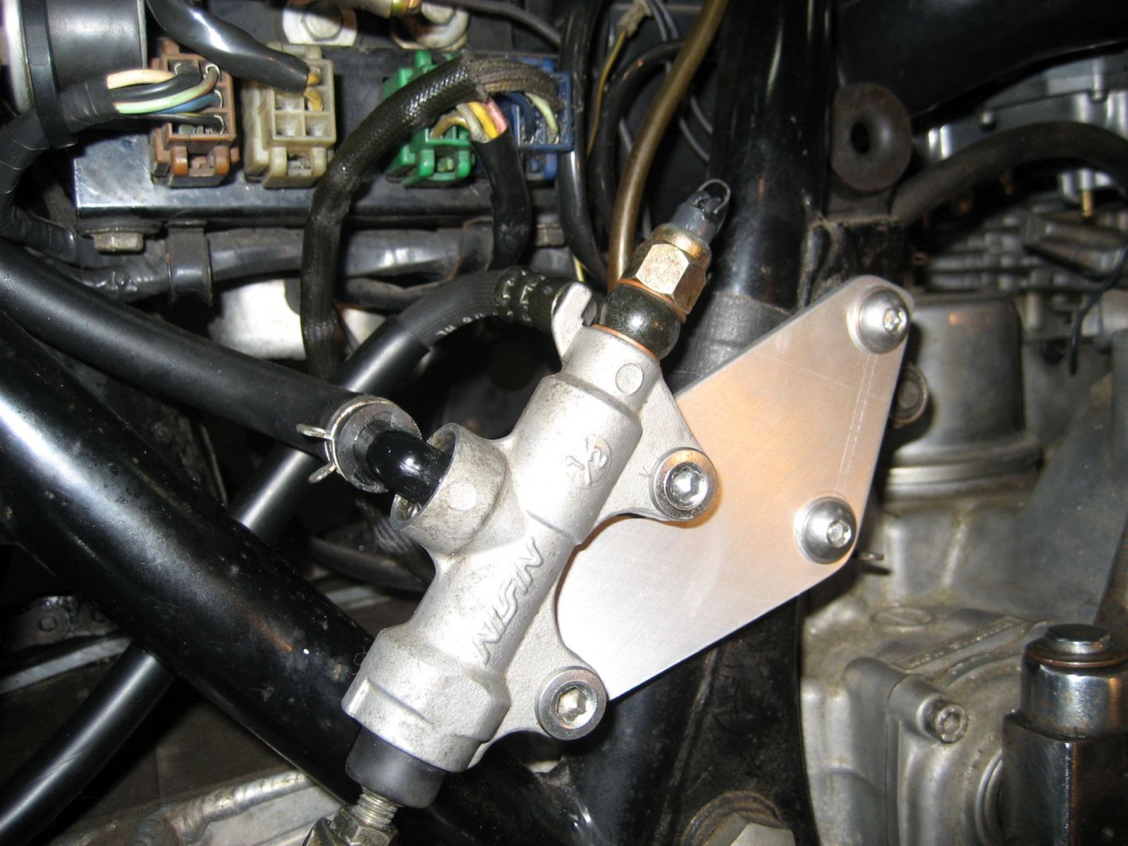

That master cylinder appears to be from an earlier model KZ. Assuming that is the case, it will not have any accommodation for a front brake switch. This is because the early dual front disk KZ models, such as mt 1977 KZ650-C1, had the brake light switch for the front brake built into the brake line splitter (see arrow in image below). Ed

29 Apr 2017 17:20 - 29 Apr 2017 17:20jdvorchak wrote: Thanks to both of you. It's a shame because the MC is in really good shape but I have to have a front brake light switch. That splitter looks like it's built into the bottom triple tree. I think it would be easier to get a new MC that has the built in switch.
It isn't. It is simply bolted to it with the two bolts shown here. Ed

The mounting holes on that brake line splitter probably don't line up with the 750H brake joint mounting holes.

That's probably true. If so, a small adapter plate could be made to mount the splitter. Ed

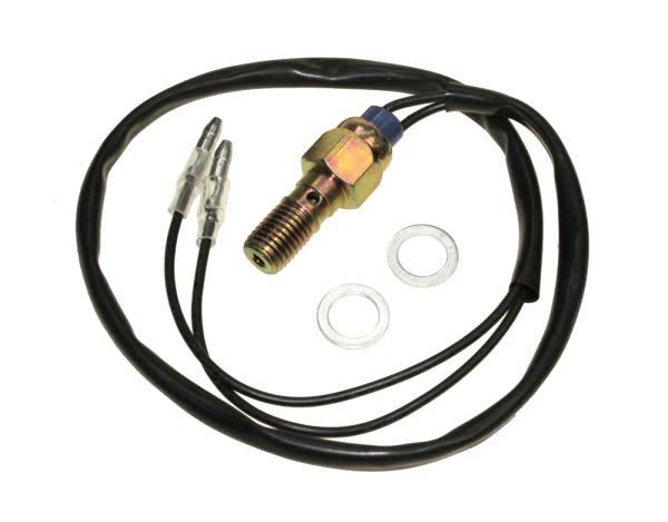

If he could add that brake light switch in Scirocco's reply, then that might be the simplest thing to do.

I wish I'd seen this before I ordered a new MC. I have a new one on the way with the switch built in. That banjo bolt switch would have been great mounted on the splitter.

But I have no problem keeping the new MC for a different project and using the banjo bolt switch on this bike. I'm not in a hurry to finish this bike anyway. I own 4 other motorcycles so the biggest problem I have is deciding which one to ride!
