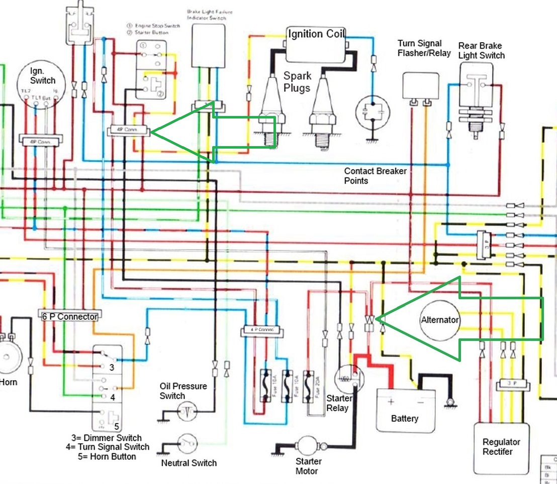

I keep blowing the main 20 A fuse and I can't figure out why. Assume I know nothing...
I have the wiring diagram but I really don't know how to read it.
I have good continuity from battery and starter relay to ignition switch (which passes through a fresh 20 A fuse).
Most recently it blew the moment I turned the kill switch to "run". So I checked continuity on all wires coming out of the kill switch:
-Good on the yellow/red to coil then coil to breaker points
-Good on the black to starter relay though both posts on relay gave continuity (Perhaps this is it? Those posts shouldn't communicate unless the relay is powered up, right? The relay did bench test well with a click and continuity between posts when powered up).
Would a crusty old regulator/rectifier cause a problem? Do I have a burnt out brake light switch? The lights do power on when the key is turned. Is it worth a newb trying to rewire from scratch or purchasing a whole new harness?
None of the rear lights are connected, by the way, but I also don't think they're grounding out anywhere.
Any thoughts?
Any thoughts?

Start with this....
Have some spare 20 amp fuses....
See green arrows...
1) Dis-connect the the 4P connector to kill/start switch & Red/White conductor feed to the Regulator....
2) Turn on the ignition switch....
Fuse Blow again...?
If no, eliminates pretty much all electrical lighting circuits where problem lies in switch assembly itself (internal short)
or shorted ignition coil.
3) Turn off ignition switch.
4) Re-connect Red/White conductor connector feed into Regulator/Rectifier
5) Turn on the ignition switch....
Fuse Blow again...?
If yes then have a shorted Regulator/Rectifier
6) Turn off ignition switch.
7) Dis-Connect Red/Yellow conductor feed into ignition coil
Re-connect 4P connector into stop switch.
9) Turn on the ignition switch....
Fuse Blow again...?
If NO.... Then switch assembly not your problem of short.
Most likely shorted ignition coil or Contact /Breaker Points shorted capacitor for example in blue feed to ground
If YES Short in Switch assembly....
Your manual should provide a trouble shooting guide for resistance measurements ranges of a good coil
Hope this provides some starting points for you....

disconnect the front brake light switch.... had this happen on my 77ltd, when the front brake lever was pulled in as if stopped but slightly holding brake to keep from rolling it would short out and blew fuse.. did not blow when pulled in as to stop from a roll, or when lever not pulled at all. the front brake light switch is metal and directly screwed into metal.. the rear brake light switch is plastic, no metal, can't short out..
