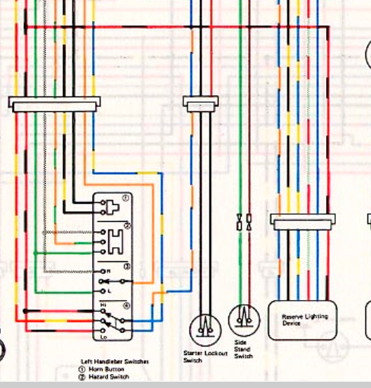

I'm thinking if I jump the blue wire ( fused power) to the blue/yellow and the blue/orange I can probably get rid of the reserve lighting box.

Can you show the whole schematic?

I'm at work now but the diagram is in the filebase.
I'm thinking just jumping the b/y to b/or might work and free up a fused circuit.

I jumped the blue wire to the blue/yellow and blue/orange and it works without the relays. I can hear the relays clicking when they are hooked up but I'm not getting any light. Good enough for now.
I'm going to email the vendor and see if he has any insight. I'd still like to use the relays if I can to take the strain of the switch and put the light on it's own circuit.

I've concluded that reserve lighting system is responsible for the whole issue. Joe said he thinks the only way these relays would burn out is if there was a no load connection directly to ground. That to me sounds like something the reserve system would do.
