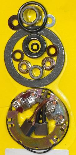

Was looking at a rebuild kit last night when I was looking for a fuse block for another member. I should have saved it. It comes with bushings and everything else.

No eBay APP ID and/or Cert ID defined in Kunena configurationI saved it on my lap top in the living room.
