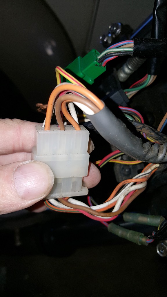

Swest I was wondering if that was the issue as well since the wires didn't match up. Here is the ignition hook up. Both the bike side and switch side

Well, no matter what version of the wiring diagrams on the forum here for 1000cc models, they all use that thick white wire from the 20 or 30 amp fuse as the main power supply to the ignition switch.
The other fuses become powered after going thru the ignition switch - so those other fuses rely upon the white wire TO the ignition.
I see in ur pics that u have 2 white wires inputting to molex... these 2 white wires are connected together (ie: same white wire branches to 2 inputs.
Thus, you should read 12vdc AT the molex white wires. If u do not, then the problem is between molex & 20/30 amp fuse.
You said ur fuses are all good so i assume u can read 12vdv AT the white wire AT the fuse.
Now ur aftermarket switch...
I see how the wire colors change across the molex. I would expect the wire functions NOT to change regardless of wire color because the mokex connector is forcing u to connect it only one way.
IF your white wire (s) DO have 12vdc AT the original side of molex, then you need to review the aftermarket switch (at the base where wires are soldered to it) and look for any identifiers that can help to determine how those wires may need to be swapped.
Maybe the switch has a diagram it came with that explain the switch's contacts?
Do you have a multimeter? It will be easier to figure out how that switch is configured & therefore how the wires may need be swapped around at the molex connector.

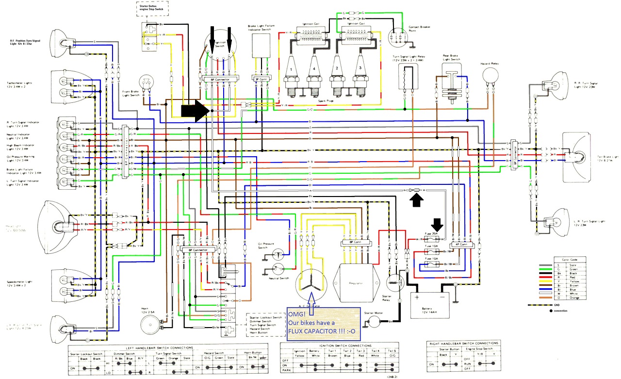

Here's the diagram I was using recently for reference sake, so we both are looking / talking about the same thing:
Use your test light or meter and confirm you are getting power at each point where I've put a large black arrow. This is the input source voltage to the ignition apparently.

Thanks bud! The wire is coming out from the other side of the main fuse and has a female bullet connector on it. That's the same diagram I am using just a clearer version of it. As soon as I get home I will check for power. If you look at the ignition swotch the white and white/black wire are in different pin locations than the harness. If they used the same wire color then it would make sense that I have no power since it's going to the wrong place. I found one on eBay that's "gently used" for $15 that I think o might pick up. If it works then I will be sending that Emgo unit back. The have a reputation of producing less than great quality parts.

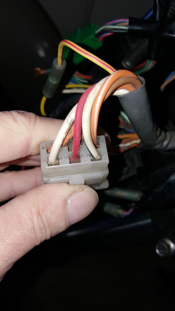

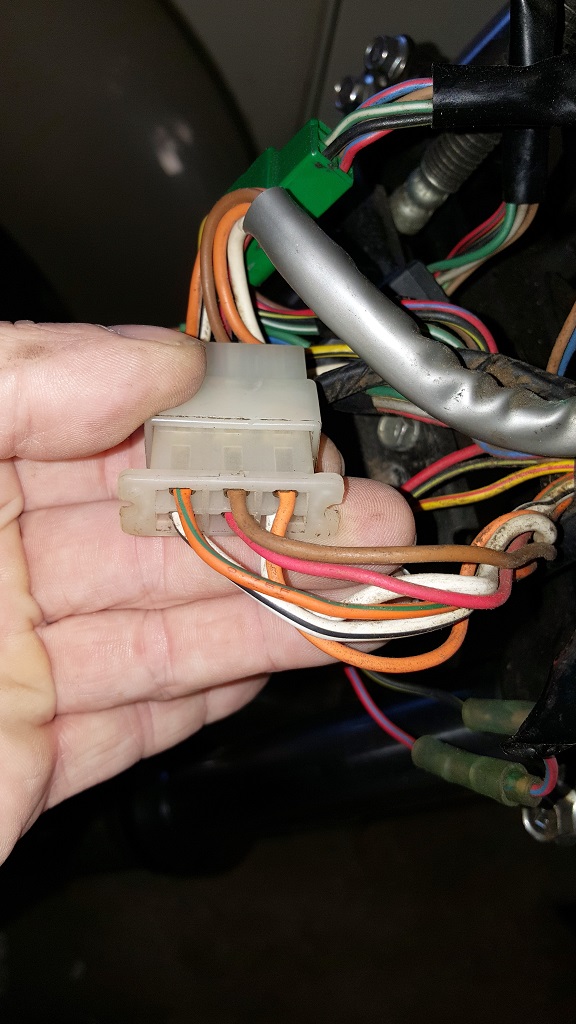

It then occurred to me, that your bike has likely more of an issue with the aftermarket ignition switch's pin-out to the molex connector. So I took 6 pictures from every angle/side/end of "the stock" installation, hoping that you may be able to see where your wires are different:

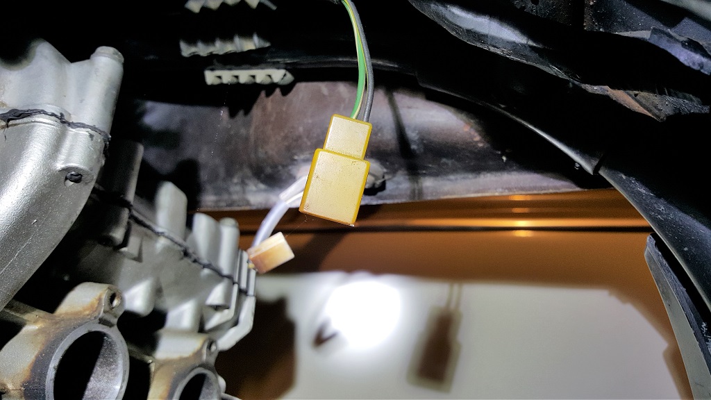

Finally, you asked about the "reserve lighting unit"? I had no idea what this was. I looked at the wiring diagram for ...? a long time anyway trying to find something to match this but drew blank.

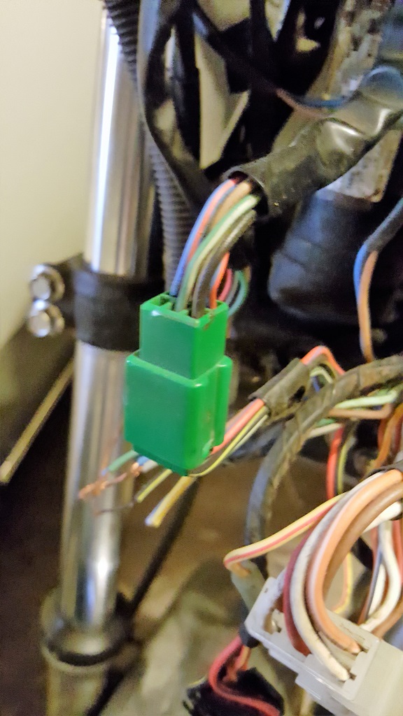

Went out to my bike in the garage (it was already dark outside and my damn ph battery was so low it wouldn't flash) BUT I did manage to find something about reserve on the tach. Ha! Go figure! I didn't even know this existed on the bike - a reserve light for the fuel tank. Cool!
So here's a couple of pics of what I got. A shot of the connector below the tank showing wire colors and then a shot of the front molex connector that goes to the tachometer where the reserve light is located. Luckily, the two wires seen at the tank connector are up-front and visible on the molex by the tank. My molex connector is green however, not brown. Doubt that makes a difference but ...:
