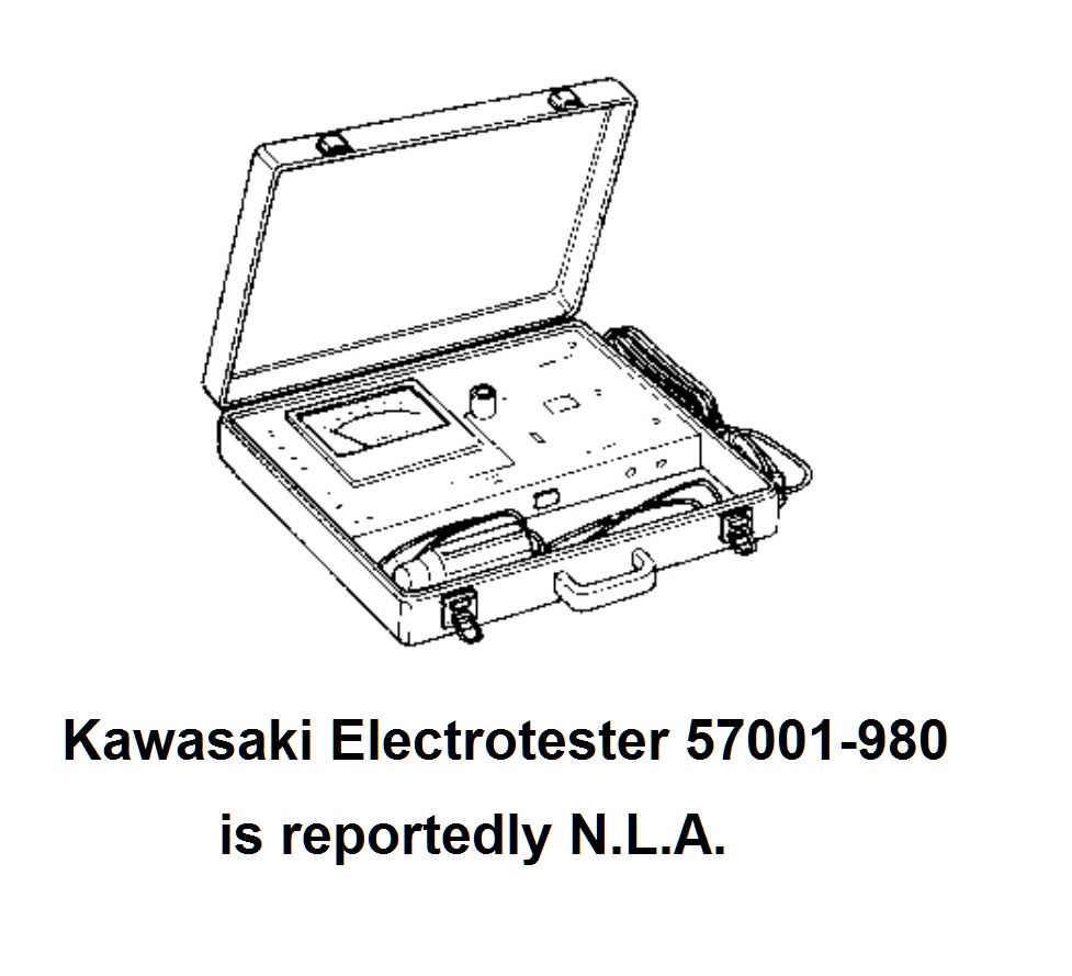

14 Mar 2016 09:51But they don't wear out and it's likely that many techs in many shops still have them available and still use them to test performance of an ignition coil under real world high rpm conditions.
With the electrotester, the test is quick and easy, and more fun to watch than the lightening scene in a Frankenstein movie.
