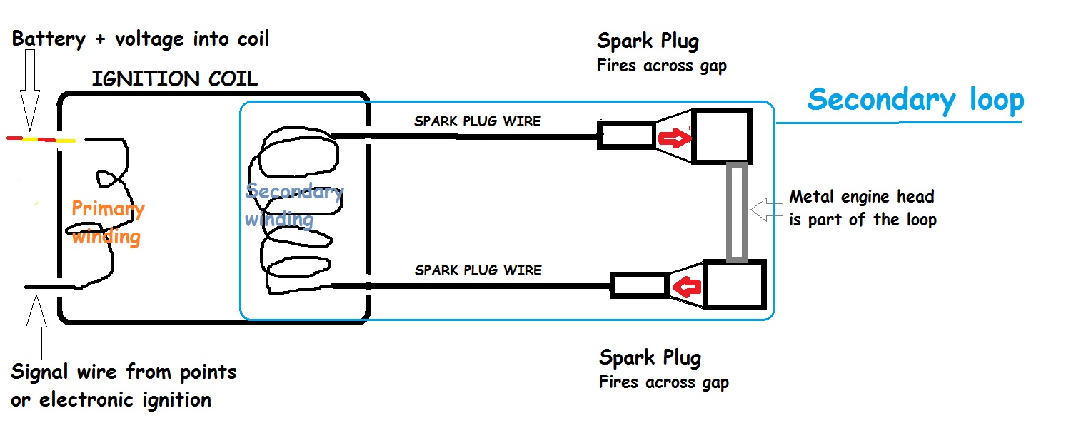

Coil primary winding should reach ground through closed points.
Opening of points disconnects the ground, which causes the coil to fire.
When the coil fires, high voltage is supposed to travel through the secondary loop.
A break in the secondary loop, for whatever reason, prevents firing.
The break could be anywhere, such as coil>wire, wire>cap, cap>plug, defective wire, defective cap, defective plug, etc.

23 Feb 2016 09:22Patton wrote: Coil primary winding should reach ground through closed points.
Thanks for the help! I can recheck my points gap to make sure, but it was firing before the mod.
As of this past year, these are new coils, new caps, new wire, and brand new plugs. I can reseat everything just to double check though.
