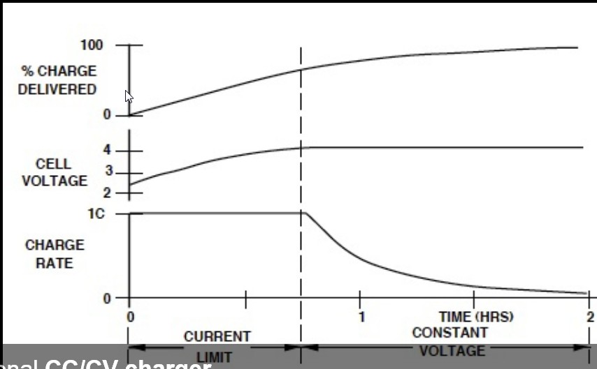

17 Feb 2016 18:14 - 17 Feb 2016 18:18I found this plot of a typical CC/CV charge mode for an Li battery. It shows how the charger holds the current constant until the battery voltage reaches the "set point" then it tapers off the current and holds at constant voltage (this plot is for a single 4.2V cell). This is the ideal characteristic for Li charging. A bike's electrical system has nothing to limit the max current during the CC mode.
NOTE: the "1C" charge current refers to the A-hr rating of the battery. A 14 A-hr battery has a C rate of 14 Amps.

Pardon my ignorance, special chargers are mentioned here but on the site I bought the battery off states that no special chargers are required. Any comments??
I have to admit, this site doesn't state that but the battery site I had did make a statement about charging using a normal charger.
