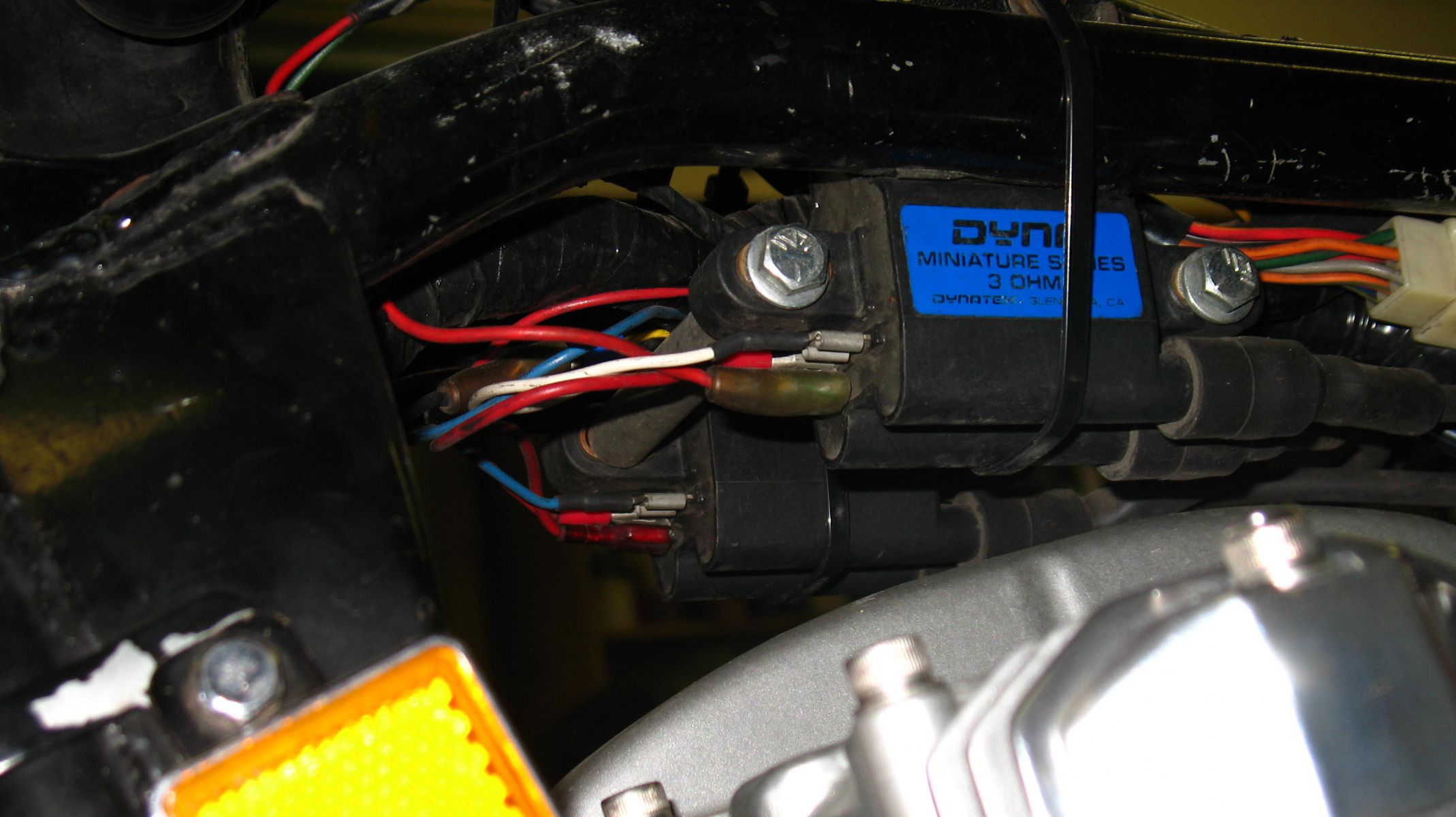

Last edit: 25 Jan 2016 14:48 by daveo. Reason: Change pic

Thanks dave! I found a set of both those and the regular green 3 ohm dynateks. Your bike looks amazing, looks like you had to macgyver those into pace a bit though. They didnt fit the original brackets?

Yep, had to improvise mounting these. Two end-tapped lengths of 1/2" aluminum rod, made a dual-coil assembly to wedge snug up-between the frame members...held firmly in-place now with a long nylon/velcro strap wrapped around the frame, eliminating the need for the zip-ties
