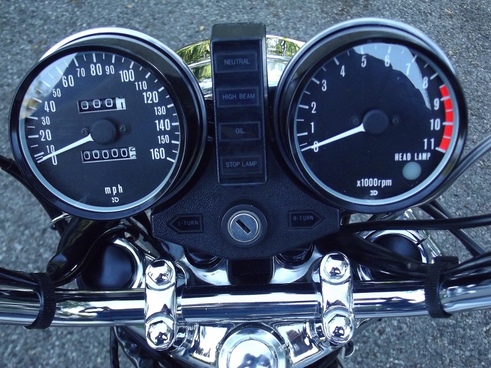

I had mine rebuilt at Z-Resto, they rebuild , calibrate & sell gauge clusters for vintage bikes
www.google.com/url?sa=t&rct=j&q=&esrc=s&...m=bv.110151844,d.cWw
This is what mine looked like when I got them back, like brand new
Pete
Pete

That's it, I'm going to strip my top triple clamp and polish it. Tired of chipped paint. They look great.
