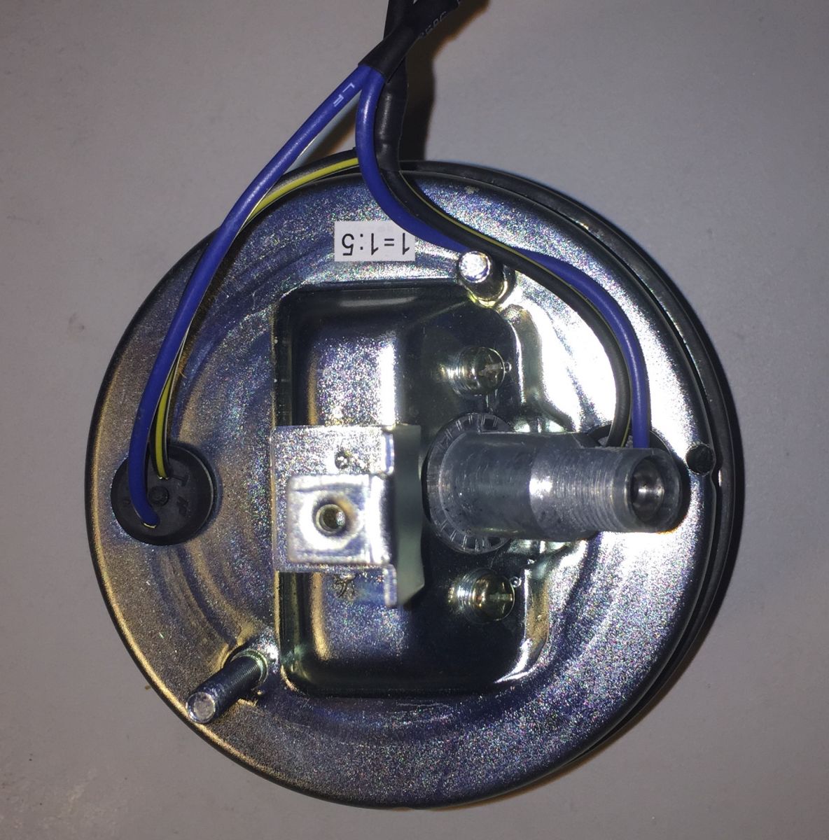

I'll take a couple pictures so you can see why the factory bracket will not allow the restro instruments to drop in... the two stud holes do line up but the box area where the gear set is and rear cover mounts to that L shaped tab, does not fit the factory casting.
I wonder if the aftermarket bracket is made by the same company as the instruments and therefore, fit?

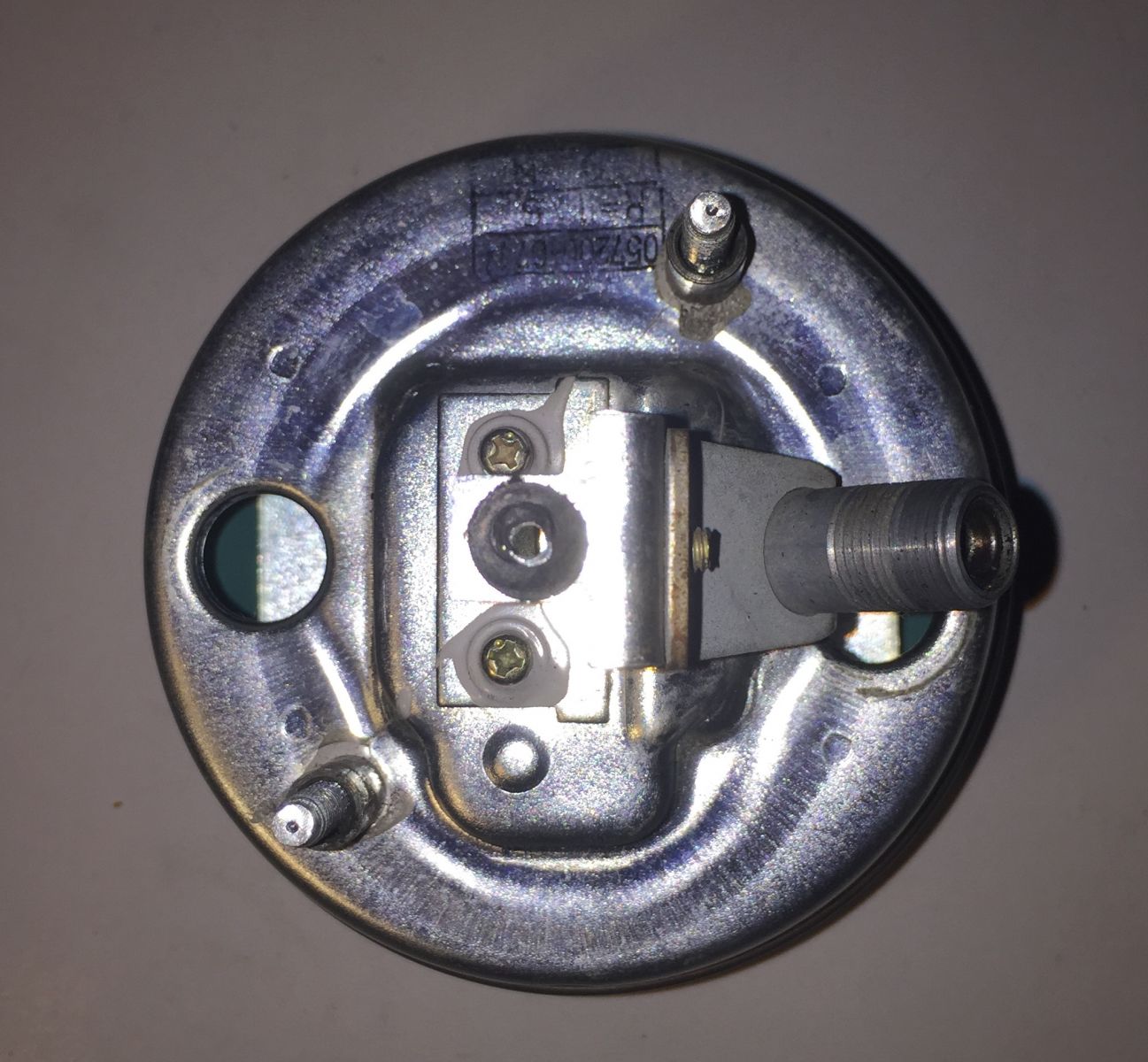

OK so I took two pictures of the two tachometers. The ones with the lamps installed is the reproduction one....
You can clearly see that the gear box drive assembly is much larger and rectangular in the repro clock. Notice how close the stamped box comes to the mounting stud.
The studs line up fine but that that larger rectangle shape makes it so it will not fit in the stock KZ instrument bracket.
Below is a close up of the aftermarket instrument mounting bracket, which assume is cast to fit either the factory clocks or reproduction.

So you would have to hog out the metal for it to fit.
