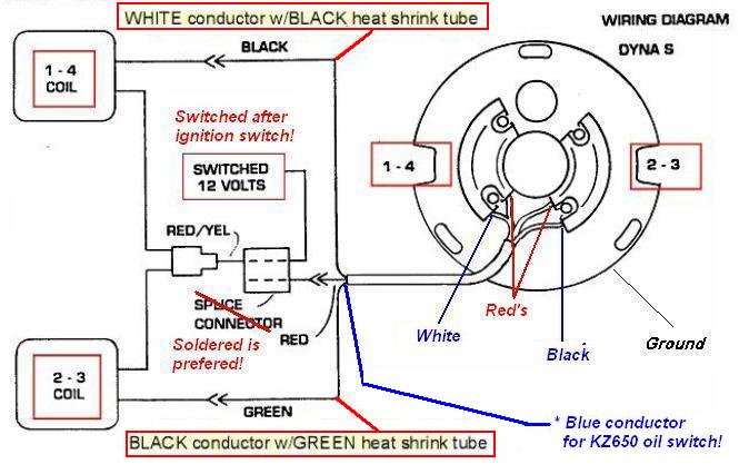

I recently upgraded from points ignition to electronic, worked fine for a week, then out of the blue the bike would not stay running. It would start then die out then wouldn't start for a while. Then repeat the process. The battery I believe is drained again. Did I fry the regulator? Do I need to upgrade the regulator and battery? Any idea on whats wrong?

I would charge the battery and temporarily put the points back in. If the problem goes away there's something wrong with the electronic ignition. Regarding the regulator; take a look in your Kawasaki Service Manual. There you will find the test procedure to see if it is operating properly. Ed

The bikes that seem to have the most problems with the Dyna S are the KZ650's with single-phase charging sytems. That would be the 78 and 79 KZ650's, (and maybe some 1980?).
That doesn't mean all 78 and 79 KZ650's will have the problem. But when the problem shows up, it's often those bikes. The Dyna S is very wasteful on power, especially at idle. Apparently there must have been some 78/79 KZ650's with weaker charging systems, but the problem doesn't show up until a Dyna S is installed. (The factory electronic ignition is very efficient, and won't cause this problem.)
Are you using a Dyna S? If so, there's likely nothing wrong with it. It's just exposing a weaker charging system.
