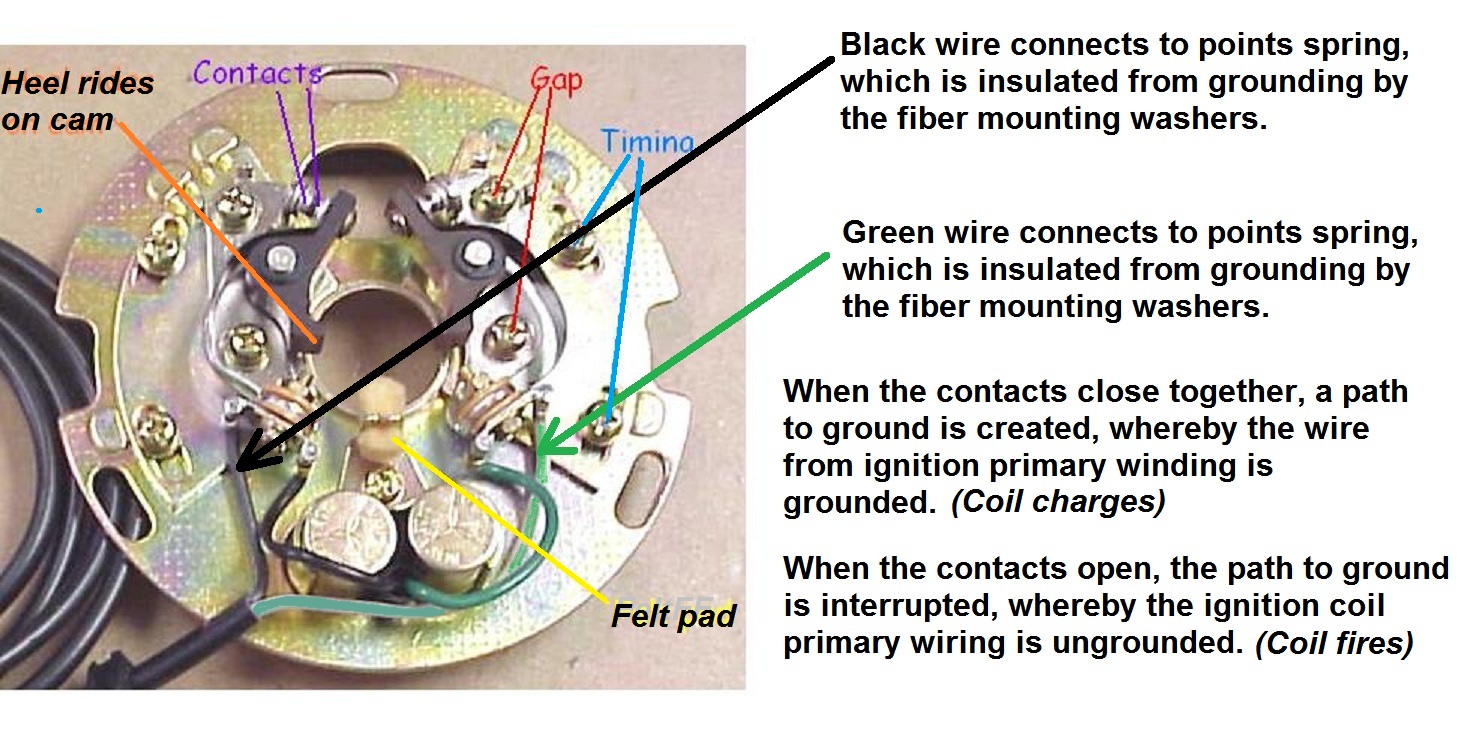

The ignition coil's primary winding grounds through closed points to the engine case.
Opening of the points is the event which interrupts the ground and causes the coil to fire.
There should be no electrical continuity between the open contacts.

Perhaps one of the insulating washers is defective and allowing some continuity between the spring and the mounting plate, even when the contacts are open.
While the contacts are open, there should be no continuity between the spring and the mounting plate.

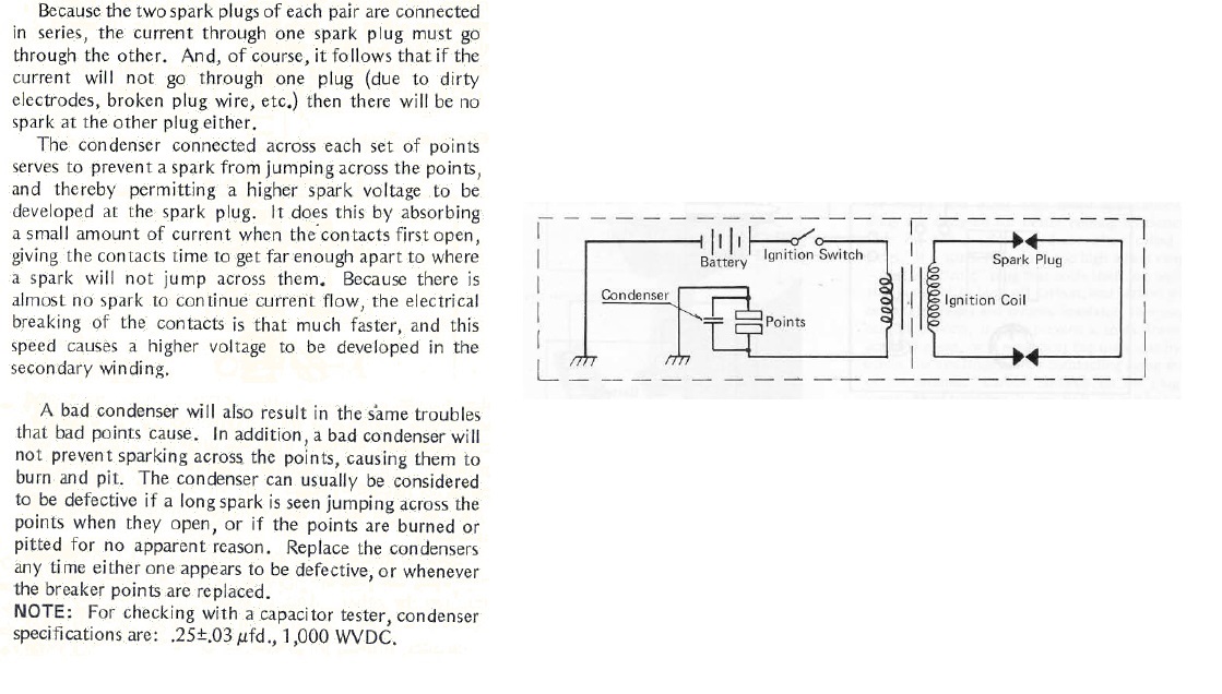

Possibly leaky (partially shorting to ground) condenser....
If your meter does not have capacitance measurement capabilities (condenser is a capacitor
), using resistance setting. Pop the cap leads out of circuit, connect your meter set to resistance measurement, connect your meter leads and you will see a ramping measurement as the cap charges up off the meter that will somewhat stabilize.
Leave it connected for ~ 1 minute, if it starts to fall off (decreasing resistance back to ground potential) the stabilized resistance measurement then it is Leaking charge potential...
Compare the two capacitor measurements, ~ the same...?
Or, if old, just replace for piece of mind, they're cheap insurance....
