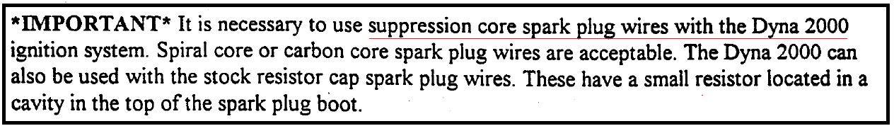

09 May 2013 22:55 - 09 May 2013 22:56The Dyna 2000 listing at Z1 Enterprises includes a recommendation of Dyna suppression (resistor type) spark plug wires, and includes a link to the Dyna 2000 installation instructions.daveo wrote: ...My bike has a Dynatek 2000, put in a couple years ago along with a pair of Dyna Mini-coils. I specifically inquired with Dynatek (Larry N.) about going with solid-core wires, and he suggested there should be no related problems created by doing the setup that way....
www.z1enterprises.com/ItemDetails.aspx?i...f1100&item=DYDDK2-1C
www.z1enterprises.com/Documents%5CDyna%2...2%20Instructions.pdf
Here is an excerpt from the instructions:
According to the reported advice received from Larry N. at Dynatek, the resistance provided by the R plugs in the secondary loop is an acceptable substitute to sufficiently replace the resistance provided by suppressor spark plug wires.
It follows that the Dyna 2000 is included among the delicate electronics that could be adversely affected by lack of a resistance component. However, such is not the case with other less sophisticated bike ignitions such as stock points, Dyna-S, and stock Igniter, which perform perfectly without any resistor component whatever in the secondary loop.
