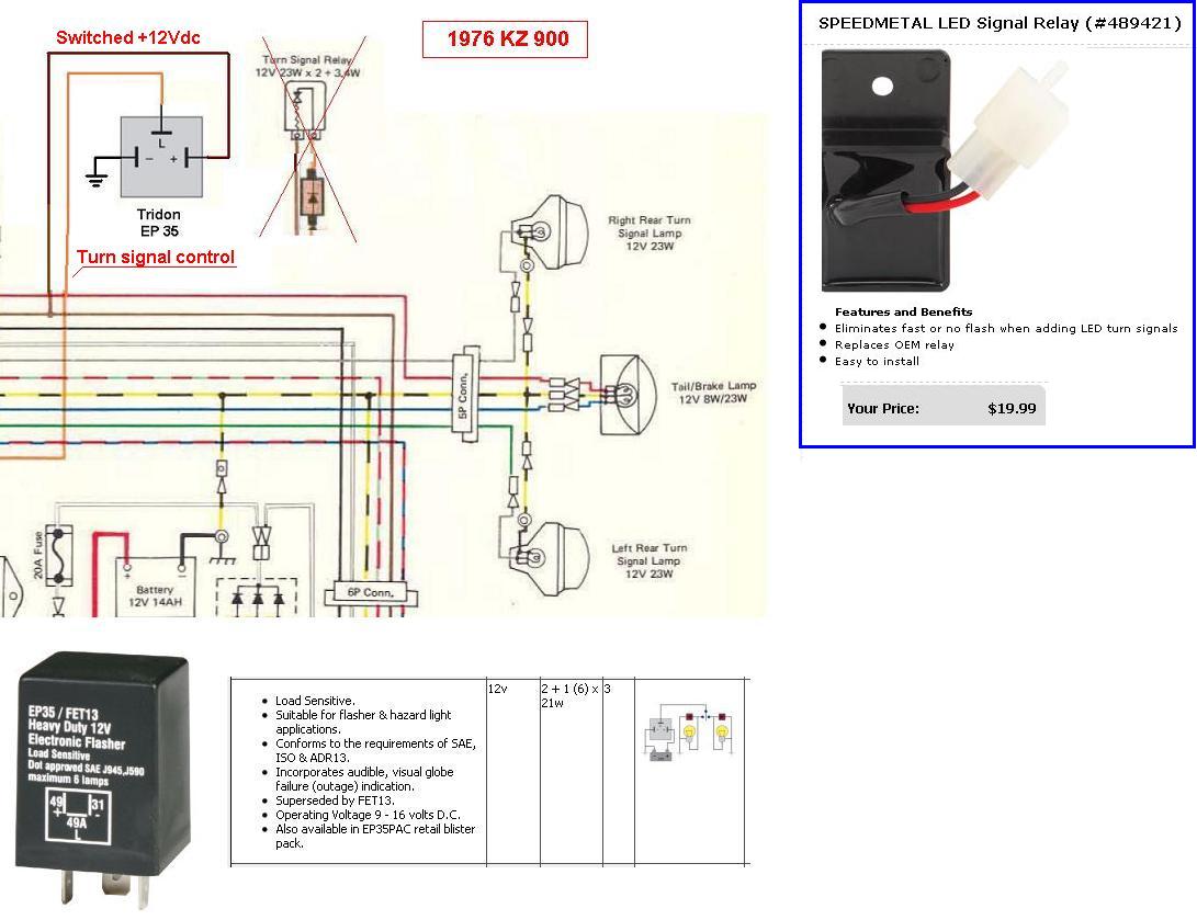

4 flasher components.... :blink:
Here's the wiring for the KZ900 using LED current sensitive relays (1 only)....
