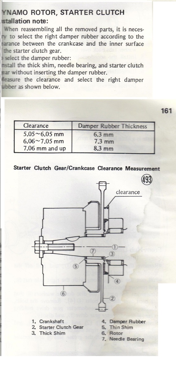

KZ_900_Z1 wrote: my starter key keeps breaking in my 1976 kz900z1. i have spent over 2,000 dollars in trying to fix it but that key never lasts longer than a month i have replaced the key 5 times and the starter twice, so what do i do?
Hello, Z_900_Z1, and WELCOME to KZrider! :cheer:
Until better advice comes along, here's an excerpt from the FSM.
Good Fortune! :)

I would imagine the thicker rubber piece would cause the woodruff to shear.

If the rubber dampener is to thick, the starter clutch gear won't freewheel. That would be your first clue its to thick. It would sound like the starter staying engaged, as it would be.

The procedure for correct fit is to use a piece of clay and place it behind the flywheel/stator magnet and tighten the parts down to specs and then remove the parts and measure the thickness of the clay.
Just trying to help out without digging out the manual.
After working on the newer design 1000 engines I found this procedure to be a pain on the 900 engines. Roy
