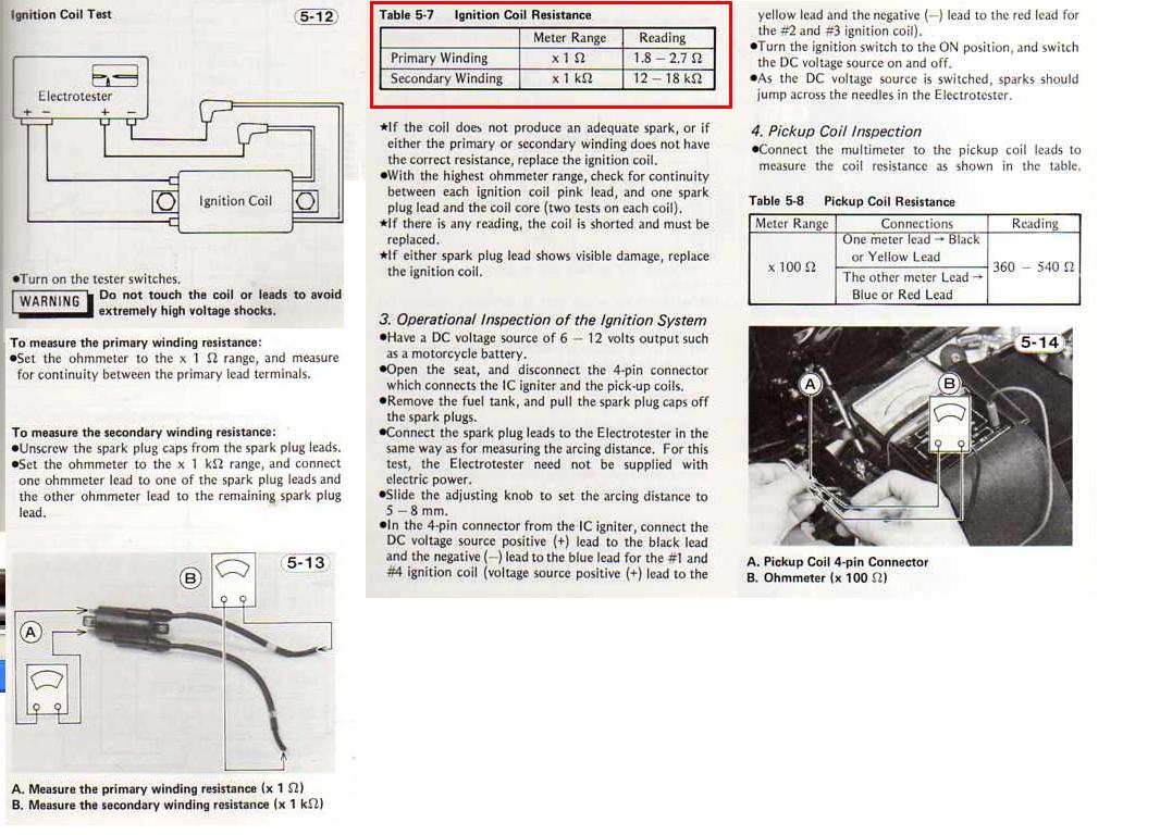

Points or electronic ignition? If points, they may be stuck open or closed, if electronic ignition, check the pick up coils(usually behind a CD sized engine cover).
Ohm Checking Pickup(Pulsing) Coils
The pickup(Pulsing) coils on the Kawasaki’s with the factory supplied electronic ignition can sometimes fail or become intermittent due to heat and vibration.
1.Trace back from where the pick up coils are mounted,(BEHIND A RIGHT SIDE, CD SIZED COVER) locate and disconnect a small 4 pin connector. Using a multi-meter set on OHMS and range of 2K, check between the BLUE and BLACK wires(#1 and #4 sparkplug wires) for between 360- 540 OHMS.
2.For #2 and #3 sparkplugs the wire colors will be YELLOW and RED, again 360-540 OHMS. The 550’s,650’s & 750’s may be backwards to the Z1’s,Kz900’s,Kz1000’s & Kz1100’s.
3.If the pickup coils are suspect of failing due to heat, they can be stressed using a hair dryer without the need of the engine running.
4.A replacement set of pickup coils might be obtained from a dealer who serviced the police Kawasaki’s.
5. If replacement pickup coils are not available, your next choice would be to order a Dyna “S” electronic ignition system from www.z1enterprises.com It replaces the IC igniter with a smaller module located where the mechanical ignition advancer was mounted.
6. Checking with Kawasaki.com website has determined that the Pick up(pulsing) coils are available . The pulsing coil # is 59026-1133 and replaces the older # 1002, 1012 which were used from the MKII motors until the 2005 P24.
7.Check the small 4 pin connector that the pickup coils connect to for corrosion/loose pins too.

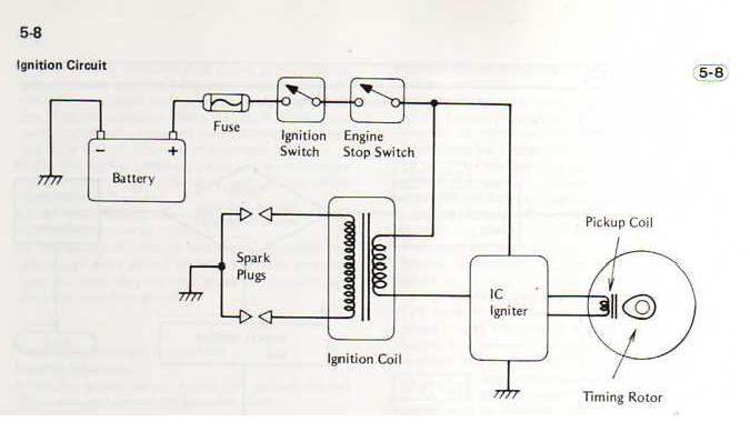

If you have 12Vdc to coils (battery power) then really a few places for no spark to plugs...
1) Engine ideally grounded...?
2) Ignition components stock IC igniter or Dyna style electronic ignition...?
If dyna for example, perform static test insuring pickups are operating thus signal to coils.
If needed... OEM Service Manual... KZ650 Service Manual
Follow manual for testing stock coils & IC Igniter.
3) Plug wires: Coils to plug wires to sparkies to spec...?
4) Handle bar kill switch deactivated?
I realize you stated you had power to coils but unknown if using coil mod (:pinch:) bypass...
