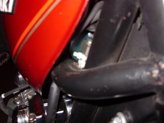

thanks guys. i pulled bike out and started spraying water on componenets. everything looks good except when i sprayed the ignition coils. than bike started missing and shut off. so i pulled tank and looked at coils. they look like they were cracked at one point and a previous owner put some sort off glue on them. apparintly it didnt work. so for now i just try not to ride in rain. bike runs great otherwise so maybe new factory style coils.

Ok so i pulled the coils off 3 days ago. the one coil had a crack running across the back side where it would mount. So i took some black silicone and sealed up crack. and some others here and there on both coils. than i started up bike and sprayed heavily with water from hose. no troubles. I rode bike to and from work last couple of days in the rain and no more ignition problems. cheap easy fix for now.
