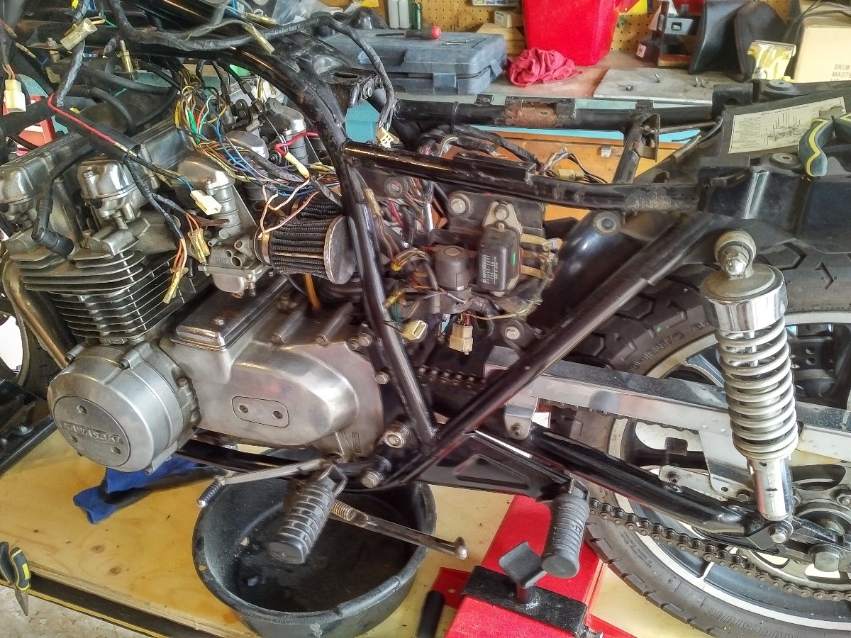

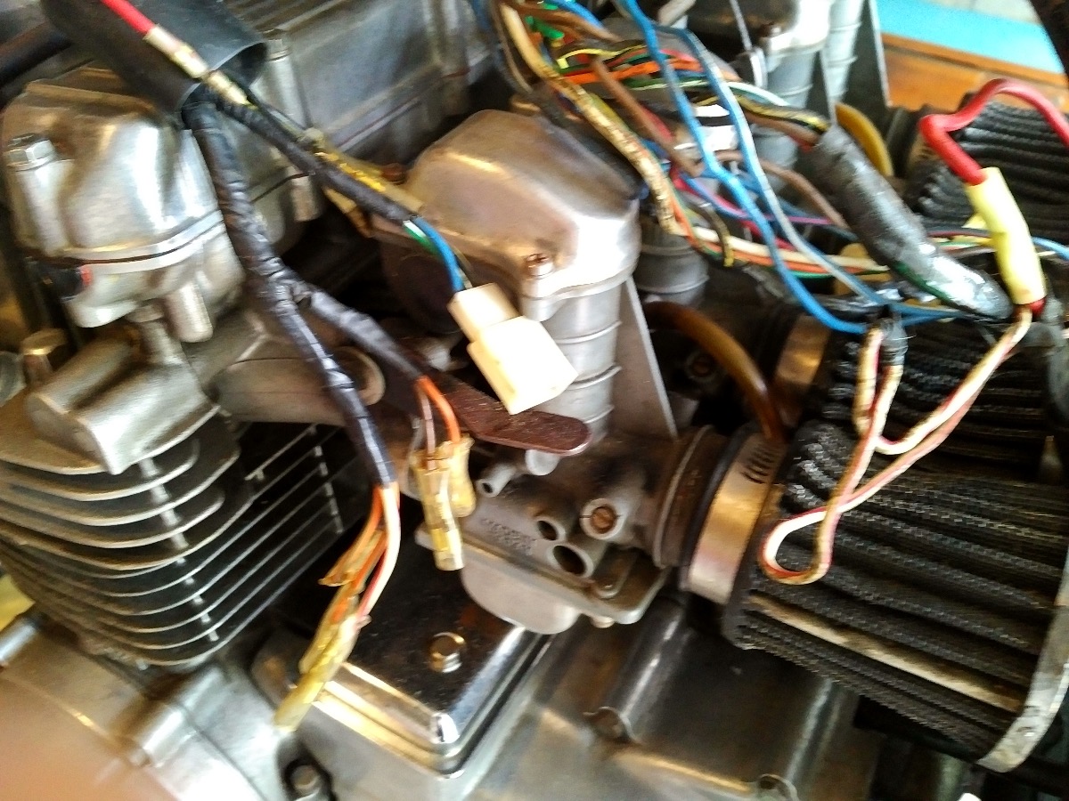

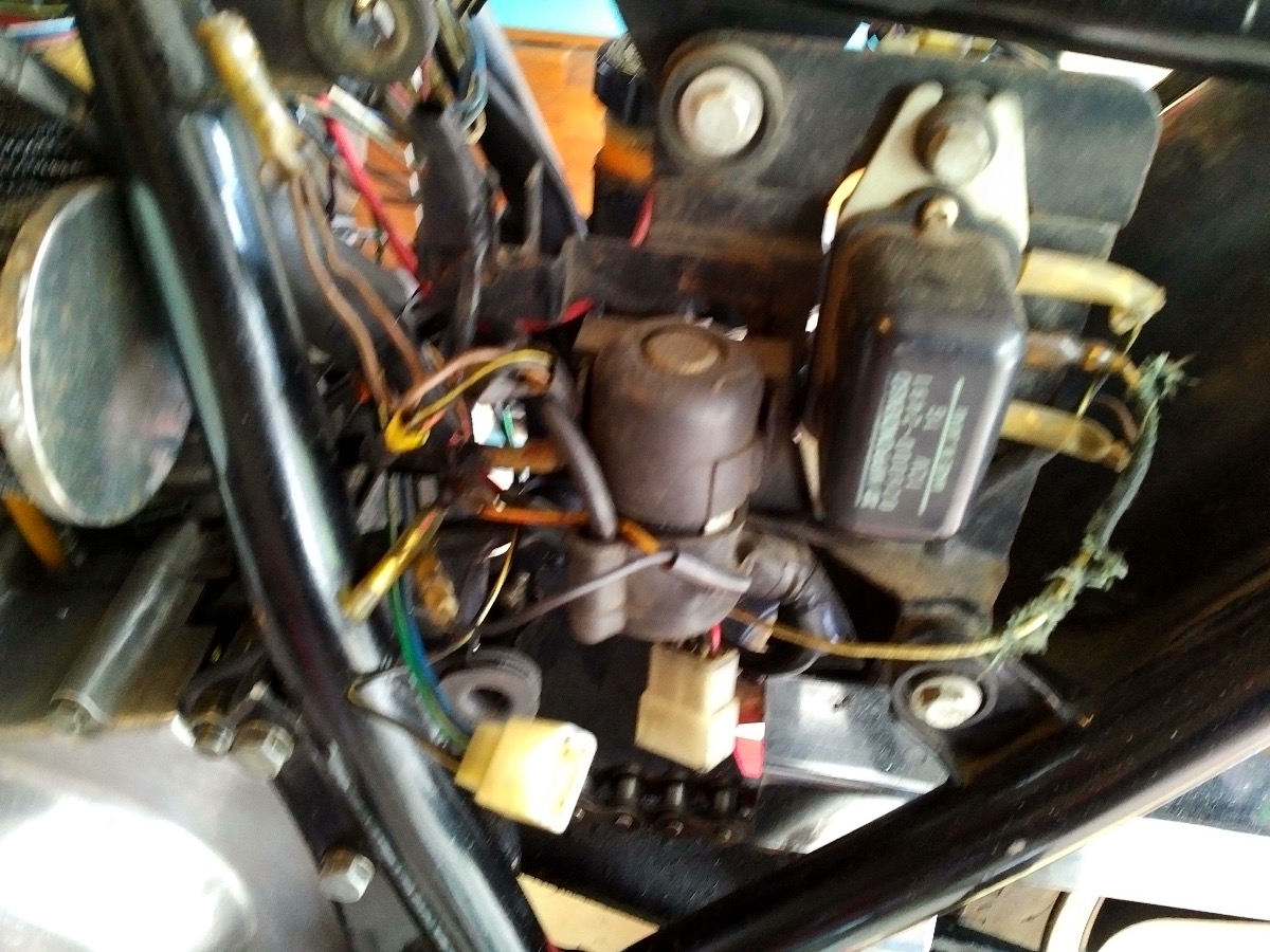

This is why I thought of replacing the system. I was unaware of the electrical mess I was purchasing.
The harness across the top is the 1979 harness

From your post I take it you would replace the missing pieces and use the original system, correct?
1977 KZ650 C
Jets - Main 115 - Pilot 17.5 - Needles - Position 3 - NGK BR7ES
Re: charging system upgrade.
13 Jun 2017 15:27
Yes.
I agree that wiring is a mess, but rather than going through the trouble and expense of replacing the alternator, left engine cover, regulator/rectifier and any other smaller pieces I would find a 1977 KZ650-C1 wiring harness or use the wiring diagram to make one. You should be able to find a used harness at a bike breaker or if you decide to make one, most if not all of the connectors can be bought new and the wiring diagram is available online. Ed

If everything under the left-side alternator cover is all there, then there is not much missing. All you need is a decent regulator/rectifier. It appears you still have the mechanical regulator, and while that can be made to work, it can also be problematic from age/wear/maintenance.
You can get a new one, reasonably at www.Oregonmotorcycleparts.com . You want the VRREM7-KZ reg/rec.
If all you need is a rectifier, a 3-phase, 30-amp (or higher) model can be had for dirt cheap on ebay.
